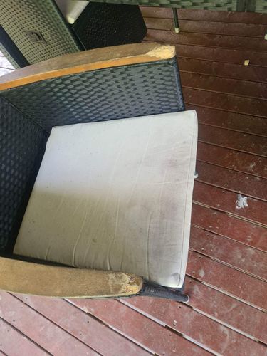

Hi, just wanting to get some advice on how I would fix my outdoor wooden arm rest. Any advice would be appreciated 😊

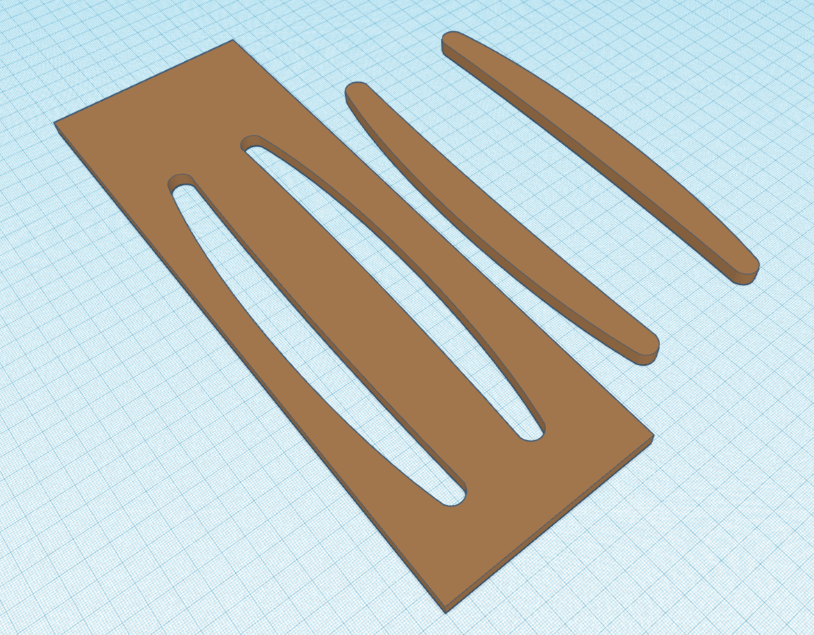

There are a couple of ways you could go about the repair. Firstly, you could cut some new armrests from a section of timber. You can use the existing armrests as a template. This is likely going to be the best solution. Alternatively, you could trim off the damaged section and graft on a new tip you've cut from timber using dowels and PVA glue. I've added a rendering below to illustrate.
The second solution, if you are happy to paint the armrest, would be using Builder's Bog to form up the end. If you haven't used bog to form up an area before, there could be some trial and error. The basic idea is to apply the bog slightly proud of where it's needed and then sand it back down into the required shape. You'll start with a large glob of bog on the end of the armrest and once it's dry, follow the armrest lines to re-create the missing section. Once you're happy with the shape, you can prime and after it's dry, paint the armrest.
