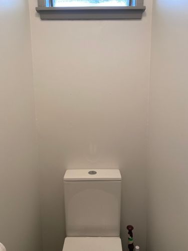

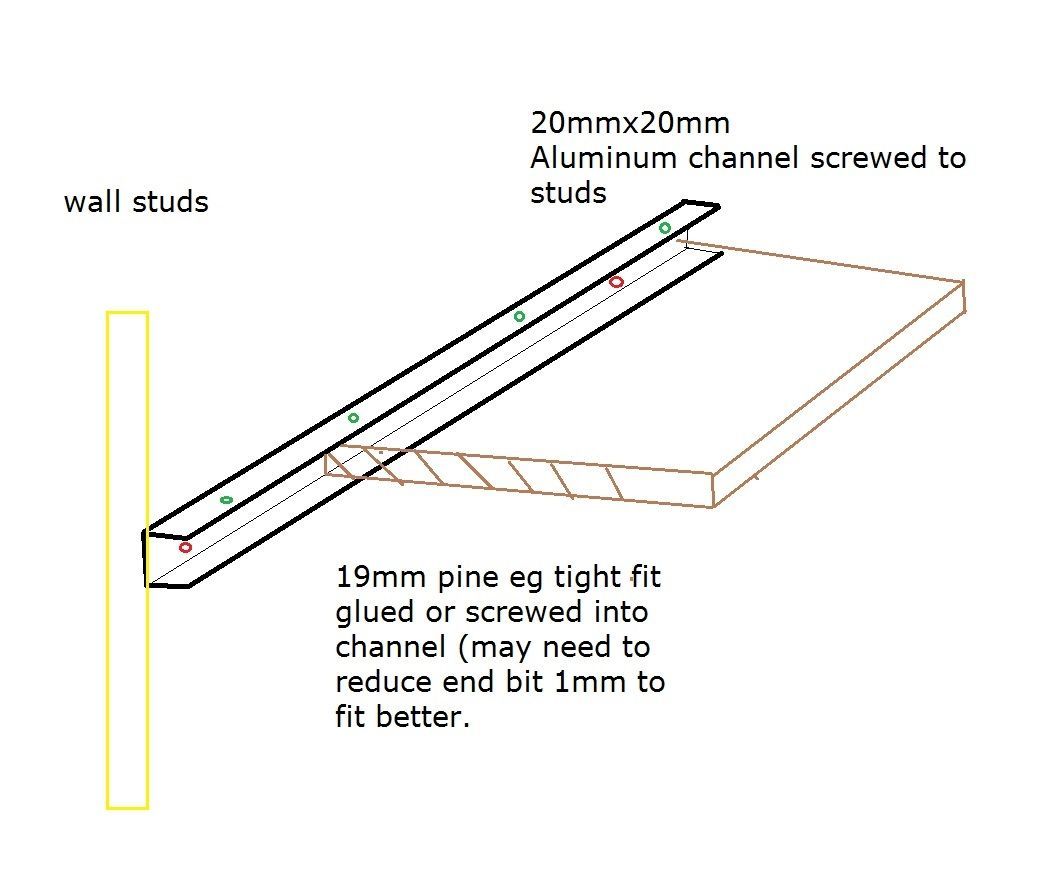

I want to put a single shelf at the back of my small WC. The studs aren’t terribly far apart, and with all the floating and single shelves I have looked at, they insist on using “hidden” fixtures which mean I would have to use the preset distance between the holes in the back of the shelf.
This might be a silly question, but if I just put brackets up, could I use any light plank of wood or wood laminate as a shelf? Or what specifically should I use? It won’t be holding much weight.
