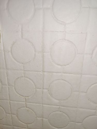

Hi All,
I'd like some advice on which brand/type of paint to buy for painting on bathroom tiles.
from what I can find out speciality paints for tiles are Dulux Renovation Range, White Knight Renew Tile and Laminate, and Rust-Oleum Tile Transformation.
All of the above products are ridiculously expensive mainly because they only come in 1L so for me doing 2 coats of my entire average size bathroom takes 4L of paint, so I'd have to spend at least $300-$400 for paint itself, then there is cost of primer, clear coating and tools.
I'd like your expert opinions for more economical alternatives, main characteristics of the paint is to obviously be waterproof and stain resistant.
I have used Dulux Wash & Wear Low Sheen successfully over tile with a good primer, and it's done well for over a year. the only issue I've had with that is that stain and dirt sticks to it and it won't wash off easily. I wonder if the above speciality tile paints are improvement on Dulux Wash & Wear or if they'll behave similarly.
keen to learn your thoughts,
Thank you all.
