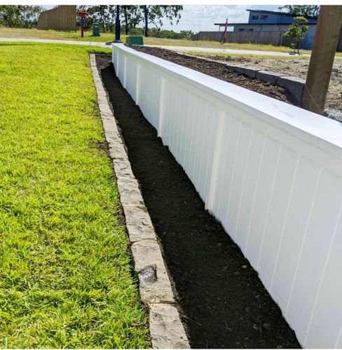

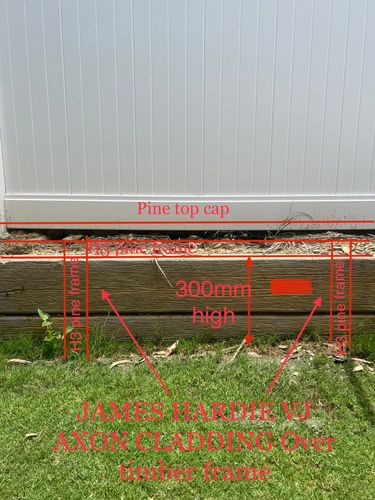

We have a 300mm high by 30m retaining wall that runs down one side of our house that we hate the look, we also want to raise the hight roughly 70mm to the bottom side of the fence so we can dig out some weeds and install plans along the top. The plan is to attach some H3 timber framing to the concrete retaining wall and put some James Hardie axon cladding over the top to match the fence (Inspo pic supplied) iv drawn up a picture (supplied) of what I plan to do but any help with what products I should use to attach the side of retaing wall and top would be great appreciated 🙂
