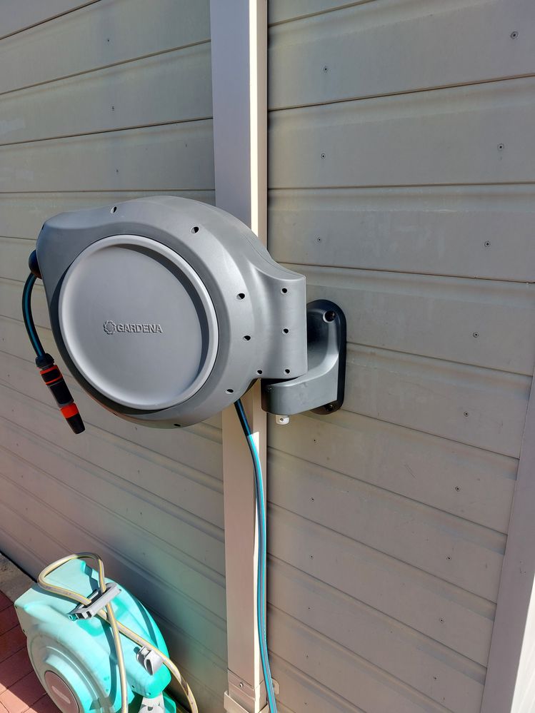

Want to mount gardena 8045-25 hose reel to house in lifestyle village hardie plank cladding 9mm. Steel studs.
Can I use hollow wall anchors (molly's) mounted in stud where possible. Any help greatly appreciated 🙏

Thank you very much for the update. I'm sorry the toggles did not work out. The hose reel mount looks to be ok and I don't see any bending or warping from the Hardie plank.
Again, thank you for sharing your garden reel mounting project.
So much for wishful thinking. Stud detector wouldn't calibrate bought new battery still saame works on inside wall but not outside. Used magnet located studs drilled holes after buying 13mm drill bit. Tried to fit flip toggles no chance plastic broke toggles dropped inside cavity, seems studs are chanel, so not enough room for toggles to open!!!!!
Went back to original plan andd used molly 6mm bolts, job done and mount for reel fitted just to stuffed to lift hose reel now so will put it on and take photo tomorrow FINALLY!!!!

Hi @Invictus,
Three fixings in the stud and one into the Hardiplank would be enough to mount your hose reel firmly.

Cheers Eric will go to warehouse tomorrow and get some. Can only pick up strut on 3 holes hopefully should be enough

Hello @Invictus
Welcome to the Bunnings Workshop community. It's fantastic to have you join us, and thank you for sharing your question about mounting a hose reel.
I suggest using the Tox M6 Flip Toggle Bolt as it has a higher weight rating than Mollys. Each toggle bolt is rated for 55kg and with four combined together has a holding power of 220kg which is more than enough to hold the weight of the hose reel. My only suggestion is to use washers if the head of the screw is smaller than the mounting hole of the hose reel. Please make sure that the toggle bolts are mounted to the steel studs and not just on the cladding.
