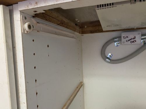

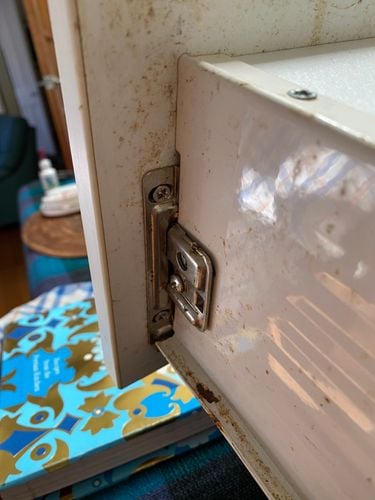

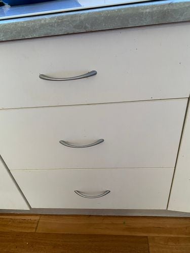

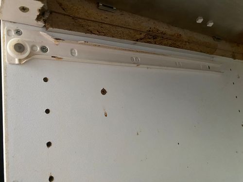

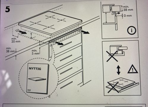

I recently had an IKEA induction cooktop installed, replacing a gas cooktop. If installing this cooktop over drawers, IKEA stipulates that you must insert an IKEA heat shield and make some space for ventilation under the unit. The instructions require you to hang the heat shield off some hooks at the top. Unfortunately the kitchen drawers in my kitchen have the runners at the top, so this is not possible. Just to be able to use it now, I removed one of the three drawers to allow for ventilation, but I would really like to purchase a new drawer case with runners at the bottom of the drawer, but reface it with the old flatpack drawer face. Preferably cutting that face down a bit to allow for ventilation at the top, and perhaps then re-sealng the bottom strip of the particleboard face with some sort of tape? The dimensions of the drawer are 56 cm across & 50 cm deep. Does Bunnings sell a drawer case this size? Which could be re-faced? &and if not, do you have any other suggestions to resolve this problem? Many thanks, KitKate
