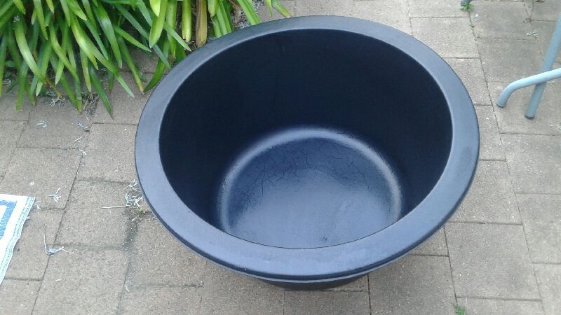

Thank you for your response Mitchell. I have two half wine barrels in my garden, each of which serves as a water feature (no fish) with water coming out of jets, I waterproofed each by painting them with Crommelin Pond Sealer, Sandstone colour. One of my barrels has deteriorated underneath with the water escaping. So rather than buying yet another half wine barrel to replace it I decided to buy a Bunnings 'Wine Barrel Liner' for $123 (black in colour) which I picked up yesterday. This liner fits perfectly into the wine barrel that has deteriorated and I now want to paint it the same Sandstone colour as the other wine barrel which is still in good condition.

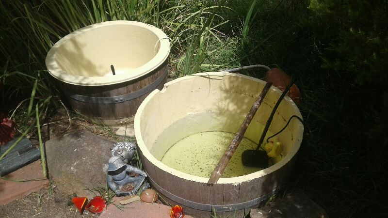

Regarding your previous advice that the chemist at Crommelins advised you that the pond sealer will not adhere to the polyethene wine barrel liner that I purchased form Bunnings, this was not the case. I applied the pond sealer to the wine barrel liner and six days since applying the second coat and letting it cure in the sun before filling it with water, it has adhered really well to the polyethene surface with no problems. See attached photos. Perhaps you can pass on this result to the Crommelins chemist who advised otherwise.

Thank you very much for that update, the pond sealer looks to be adhering very well to the pond liner. Let me tag @MitchellMc to make sure he sees the results of your handywork. Did you sand the surface before applying it or did you leave it as is and simply painted over the surface?

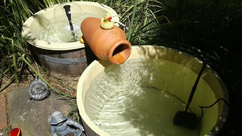

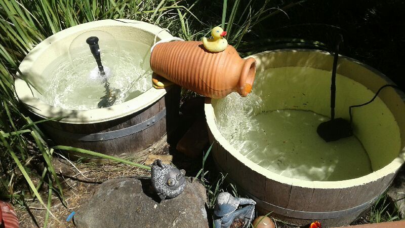

Hi Mitchell. I finally filled both ponds with water today, and the pond sealer was still attached to the wine barrel liner perfectly and none of it had come away from the surface. Ponds working beautifully as in photos. Cheers! Sebastian
Love your work, @sebastian1! The trickling terracotta pot is just fab.
