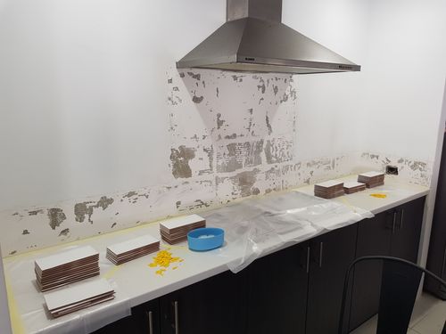

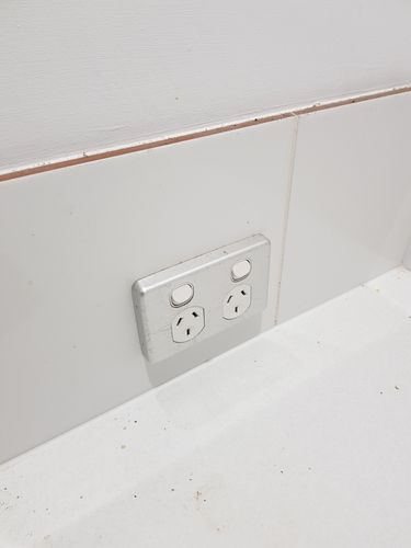

Before
Check out the ghastly powerpoints and red exposed on the tiles...

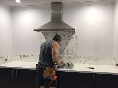

So off came the builder spec tiles (mmmmm satisfying)
Then as with any job, prep prep prep...

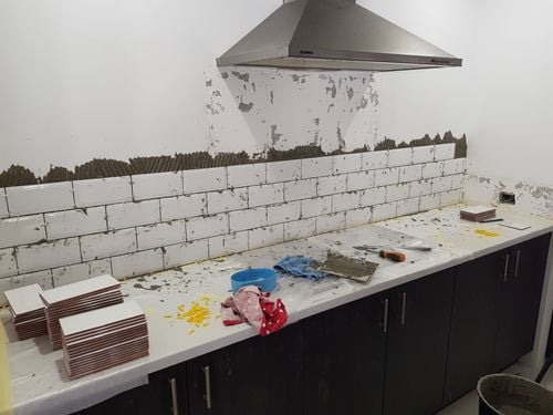

Getting the first row right is critical so take your tie, use your yellow wedge spacers and a spirit level if things are a bit off. I was going on a flat bench in great cond so no real issues for me but something to keep in mind especially if you're bridging a gap for example.
As you move up the wall it gets messy but don't stress, all that excess adhesive is easy to scrap/wipe off once it's all dry. To avoid too much mess a) don't overdo it with the adhesive, and b) just before you place you next tile run you finger along the side and top of the tiles it'll be going next to - it reduces the amount of adhesive that seaps out when you apply some pressure.
I used a grinder for all my cuts which I find easier for these small (200x100) subway tiles - you just need a steady hand. Obviously a tile cutter is a better way to go for the big tiles. Remember that if you use a grinder you lose about 4mm of the tile for your cut so if you cut a 200mm tile in half at the 100mm mark one piece will be 100mm and the other about 96mm - this is not good when following a pattern so keep the 96mm piece for small cuts you might need to make.

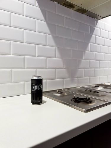

Note from the pic above what this would've looked like with a darker grout which is also common with subway tiles. We went with white to a) make the space look a bit bigger, and b) appeal to more tastes (given we're selling in a year). Make sure you seal the grout!

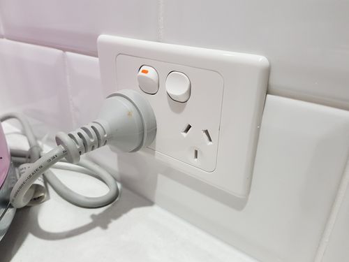

Once the (tedious) silicone is done and the new white slimline powerpoints are on, time to replace the appliances and get the 'after' shot.

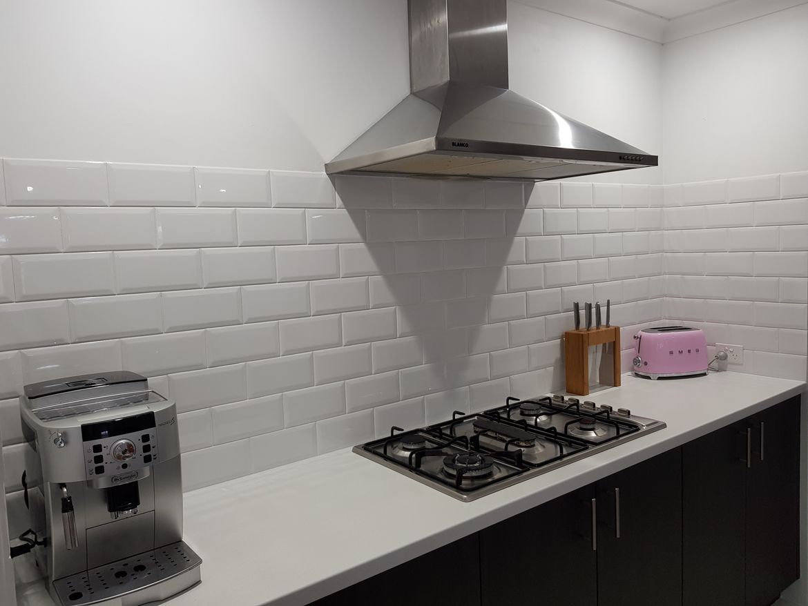

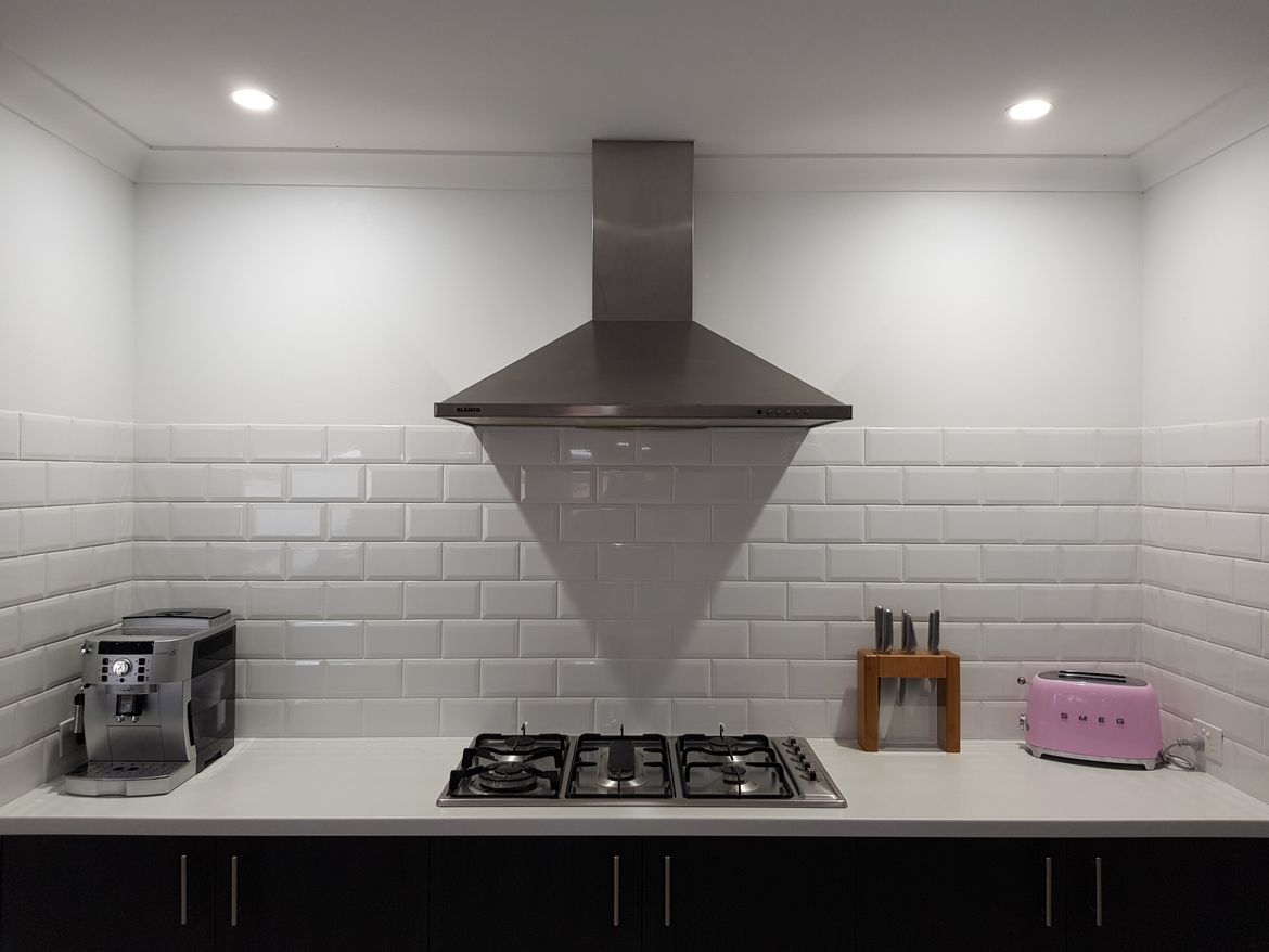

After
Would love to hear what you think...especially if you (honestly) think it'd make a difference to you opinion of the kitchen as a potential buyer.
