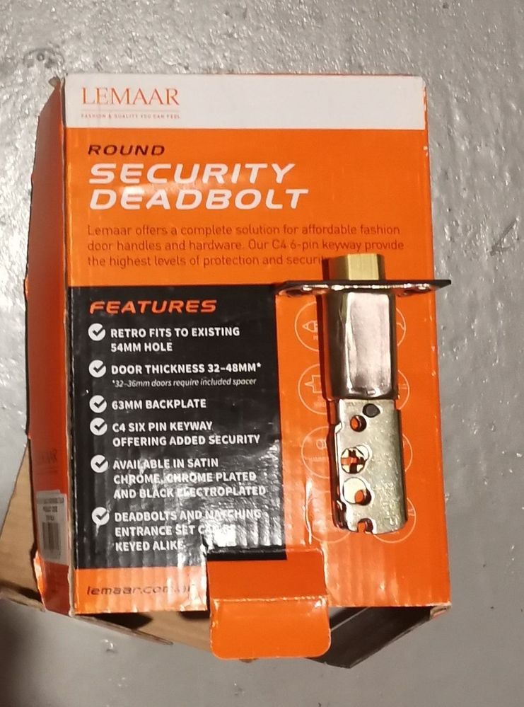

bought one of these Lemaar deadbolts https://www.bunnings.com.au/lemaar-white-double-cylinder-deadbolt_p0336096

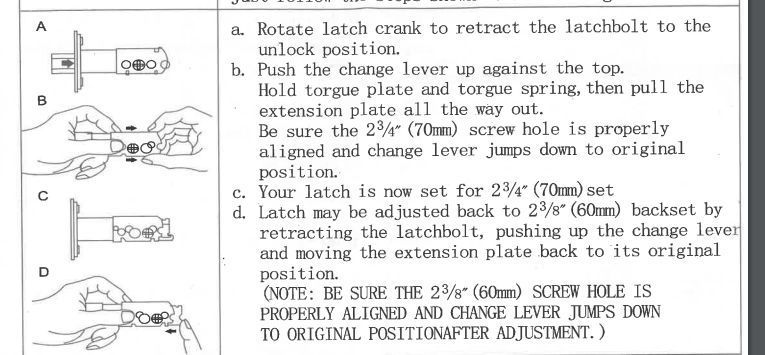

but I can't for the life of me make the bolt retract all the way in - C on the instructions below.
I followed the (crap) instructions , but the most it will go still has 1cm sticking out as pictured
Anyone have better instructions , or even better a video on how to retract the bolt?
my backset is 60mm
