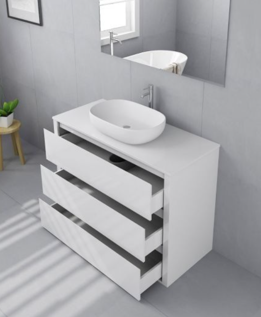

- Existing one: Floor standing vanity cupboard with wash basin shown in the first picture. Ours is quite a new house, handed over in Feb. 2020.

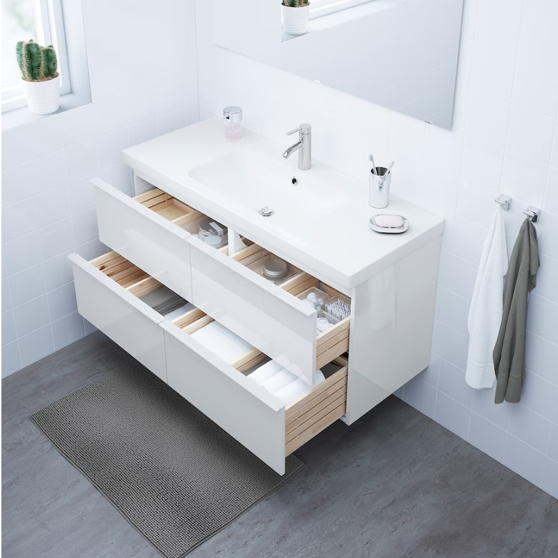

- New one: Ikea GODMORGON / ODENSVIK wall-mounted wash-stand with 4 drawers. Article Number 592.931.43

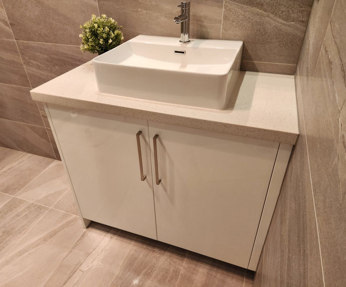

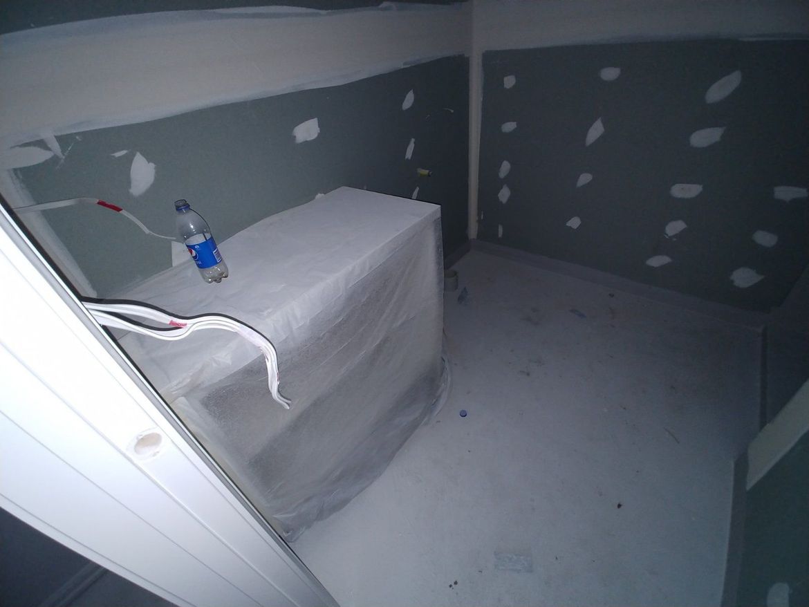

- Going by the photo from the house build, I am presuming that tiling was done after the vanity was installed. I don't have spare tiles or the tile SKU / make and design from the builder. Replacing the existing floor-standing vanity with a floating vanity (like shown in photo #2) could expose untiled wall.
- I prefer to use Ikea vanities because they have a unique waste pipe design which maximises usable drawer space below the wash basin.

Photo #1: Current vanity and basin
Photo #2: Desired vanity and basin
Photo #3: Build-phase photo of current vanity (not the same bathroom but from the same house)
