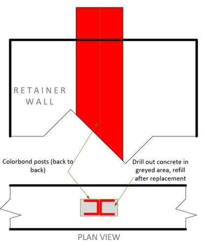

The aim would be to:
- drill out the concrete holding the posts in place with a long masonry bit down to a depth of 300mm
- Remove the damaged post (colapse it onto itself)
- Fit a new post and position
- Concrete the hole where the post is placed
- rejoin rails etc to the new post/ss
Practical, do-able, dreaming?
