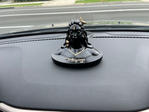

It came out pretty well. When I started with a small piece of tape to try on it won’t stick but then I just plunged all in and it did do well. Pretty stable too.

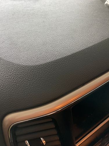

I was searching out options for car dashboard you know the soft rubber like plastic material, I tried gorilla mounting tape, but it won’t stick to the surface, I don’t want to use super glue as it would damage the surface, one of the YouTube video said 3m VHB tape but Bunnings doesn’t have exactly that tape. Would you recommend sometime tried and tested, I am just trying to attach some bobbleheads and all.

I'd recommend either Scotch™ 2.54 x 152.4cm Clear Mount Double-Sided Mounting Tape, or if you're game, you could use the Scotch-Mount Extreme Double-Sided Mounting Tape 2.5cm x 1.5m. Be warned, though, the latter might be hard to remove if you ever need to.
Regardless of the mounting tape you use, it will only ever adhere as well as the effort you put into preparing the area. The tape will peel off if you don't clean the surface and remove all traces of dust and oils. I suggest giving the surfaces a good clean with warm water and a couple of drops of dishwashing liquid using a lint-free cloth. Rinse the areas with plain water to remove any traces of soap. Then, which is especially important, clean the areas with isopropyl alcohol and wait for it to evaporate. Give it another wipe with a clean cloth to ensure there is no remaining alcohol, and adhere your mounting tape. Remember your PPE when using this product, including suitable protective clothing, gloves and eye/face protection. It's also a good idea to do a test section on your plastic in an inconspicuous area to make sure there are no adverse effects.
With the above cleaning instructions, you'll give the tape the best chance of withstanding the extreme temperatures the interior of a car is subjected to.
