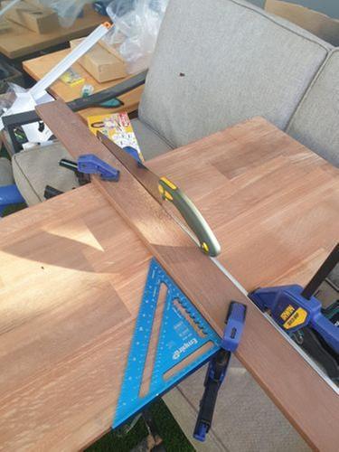

As is the norm for me, I am cutting most of these things by hand since both space and power tools are a premium for me. My trusty Zetsaw Kataba Saw and guide come in real handy for this normally, but seeing as I had to cut panels and I have no room for a track saw, I improvised. Enter the Saw Rail! Literally just a piece of aluminum extrusion and a piece of Jarrah DAR clamped to a panel with quick-grip clamps, spaced exactly one saw-blade-width apart (the Zetsaw guide kit contains a spacer to dial in the guide that's the exact width of the saw blade)
This made quick work of the SpecRite 405mm x 1800mm x 18mm Spotted gum panels, which would get trimmed into exact 405x405mm squares... Well, about as square as I could get them with what are essentially rudimentary tools.

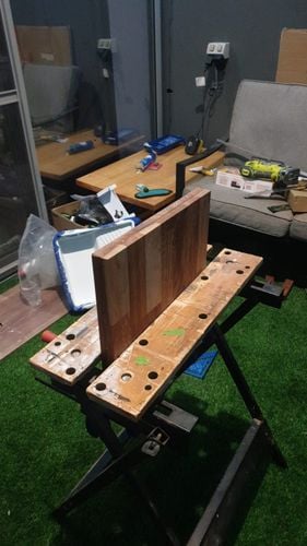

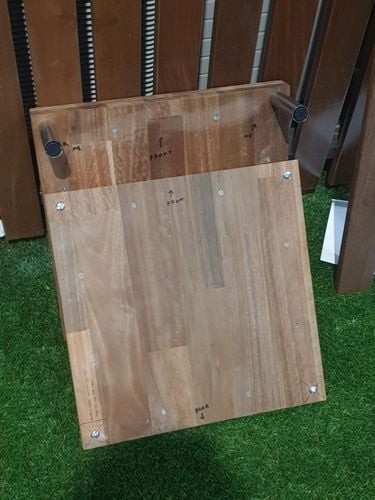

I then laminated these panels together using Gorila Wood Glue, and screwed them in the corners with pilot-drilled holes and Zenith 10gx25mm screws. I initially had a go with another pair, however I, being a clumsy person at times, forgot to spread the glue before laminating the panels! That resulted in one of my glue-ups being completely ruined, with the centre splitting upwards, causing these butt-jointed panels to split apart! Don't worry, this isn't the first time you'll see splitting panels get in the way of this job... My stepdad's old Black and Decker WorkMate comes in real handy as a clamp to clamp the centre down.
As for the corners, clearance holes were drilled for M8x1.0 bolts in the corners, spaced exactly in the centre (kinda) of a 42x42mm square. Fun fact! IKEA Bestå legs are M8 threaded, so if you need a good source of through-hole legs (apart from the ones that Bunnings sells, of course) they're cross-compatible. I chose the Bestå legs to go with the existing unit, that and it'll be easier to match them.

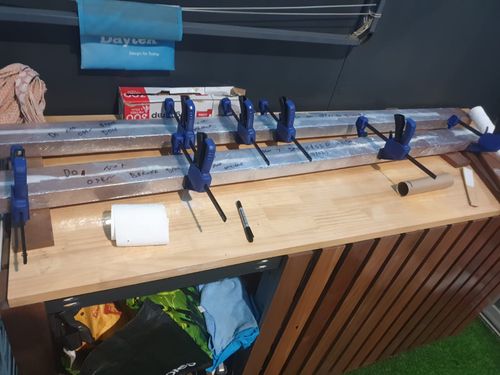

So, there's a few things that happen to timber if you store it in a hot shed for an extended period of time. Sometimes, the wood can bow, twist or warp, leading to the wood sometimes becoming unusable. In this case, this is exactly what happened... These 42mm DAR Merbau strips had a solid 10mm bow from end to end, and one of them even had a few degrees of twist. So, I did a little reading as to how I can make these have less bow in them. Turns out, steaming timber is the only way to get it to straighten out. Now, I don't exactly have a timber steamer that can take a whole 1.9m length of Merbau, but I do have a spray bottle, some paper towel roll and some glad wrap. So, I got to work soaking paper towels with water and placing them on the concave side of the bow, and clamping two bowed planks together with the concave sides facing inward, wrapped them in glad wrap and had them sit outside for a week. The end result? Well, i took out some of the bow, but not all of it, but it went down from about 10mm concavity to about 5mm, so that was at least workable, I could just simply put the shelves under tension.

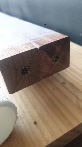

boy are these little nuggets hard to find! These Taskmaster M8 Nut Inserts are pretty hard to come across these days, so when i saw that Harrisdale Bunnings had two packs in stock (just the amount I needed in fact) I snapped them up straight away! I used some Sika TechGrip to strengthen their bond seeing as these nutserts are going into endgrain, and I used stepped pilot hole drilling to get them kinda centered.

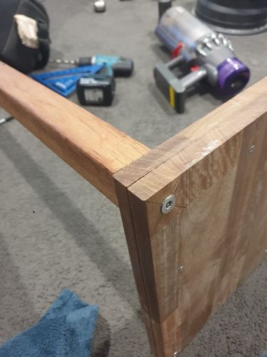

Being a sucker for punishment I decided to go with countersunk M8 bolts on the top to allow the screwheads to sit flush. I would then add an additional 10gx60mm screw on the inside corner of these to further increase the strength of the joint. Let's just say this isn't going to spin itself apart anytime soon. The bows are pointed with the concave sides facing outwards and the convex sides facing inwards. you'll see why below!

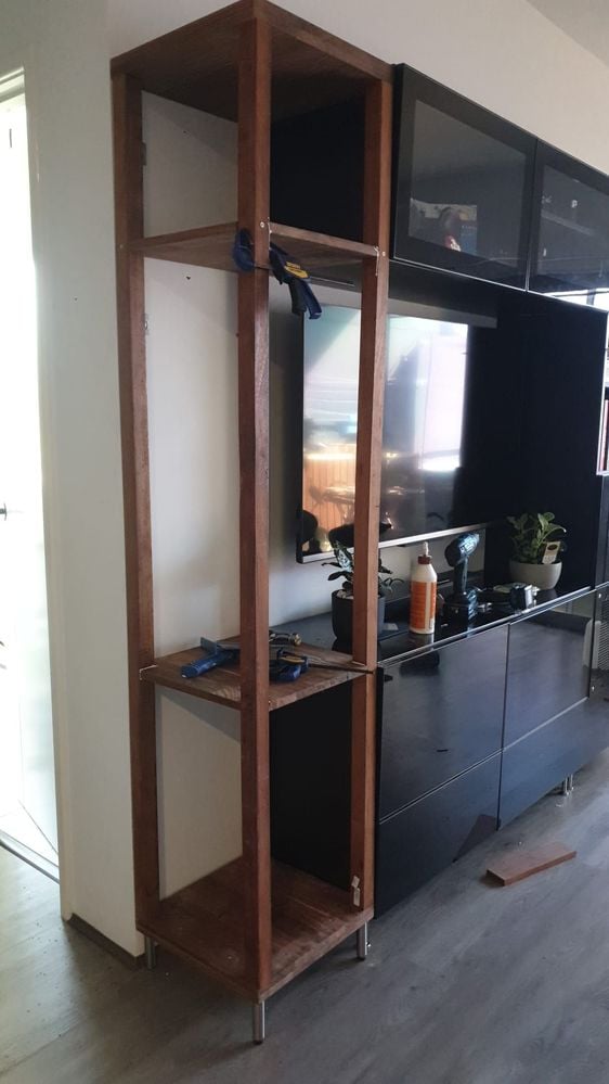

And here it is! In Situ! To get these shelves in I had to first cut out a 42x42mm cutout on each corner to make clearance for the uprights. I then had to basically knock them in with a hammer to position because of the fact that I had put the convex sides of the bows facing inwards. That allowed me to essentially square and level off the shelves and secure them on the outside faces with more 10g x 60mm screws in countersunk pilot holes. I ended up splitting a shelf, but that's nothing that once again, Gorilla glue can't fix.
