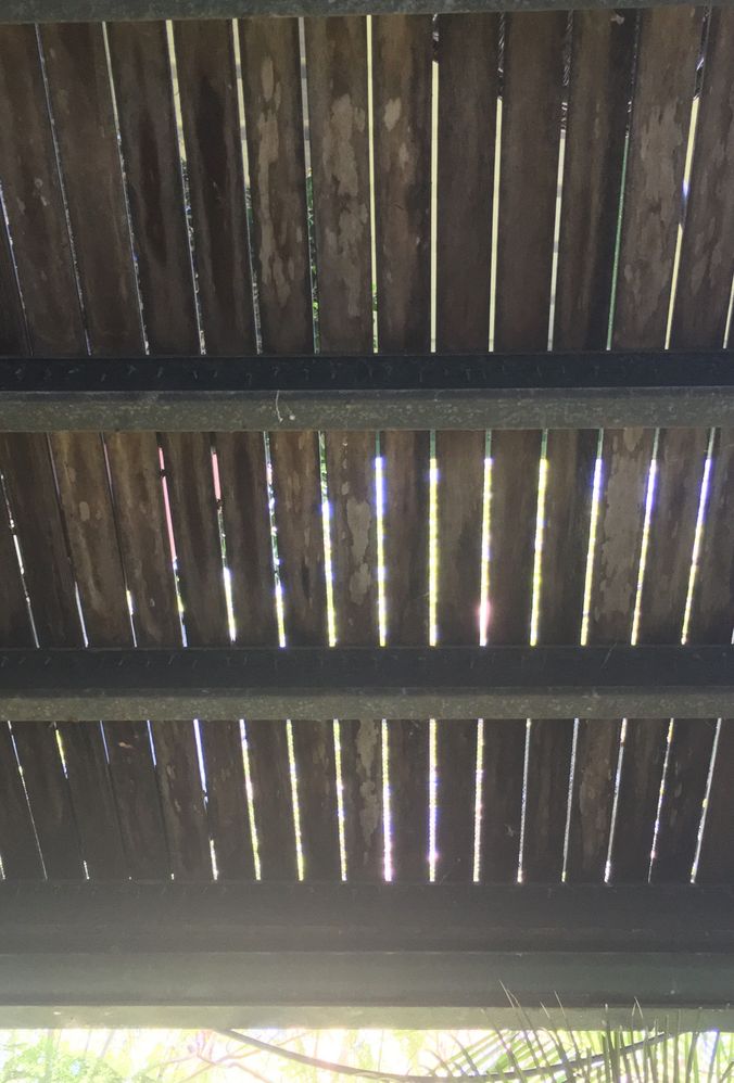

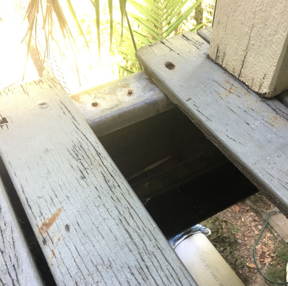

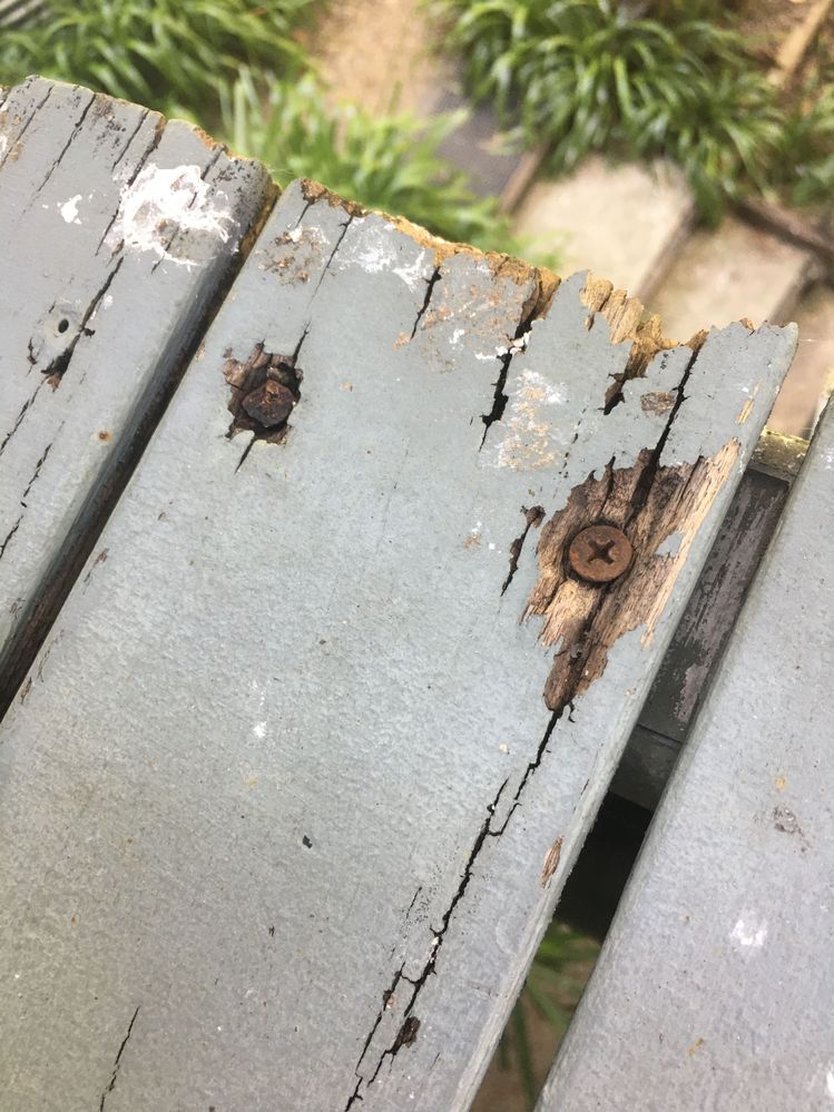

My deck will soon need to be replaced, at least some of the boards. The problem is that the substructure comprises steel channel beams (sideways) and the boards have been screwed directly into the steel. Of course, these screws weren't stainless, and now they are rusted in. It looks like I'll have to grind them all out. I don't want to screw the new boards directly into the steel, so I'm thinking of screwing timber bearers side-on to the steel channel and then screwing the boards into the timber bearers.
I guess this method will only work if I replace the whole deck, not individual boards.
Does this sound like a good way to avoid screwing into the steel? Or is there another, better way? Any advice would be appreciated.
