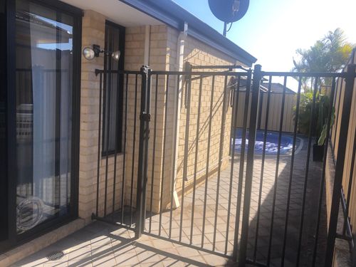

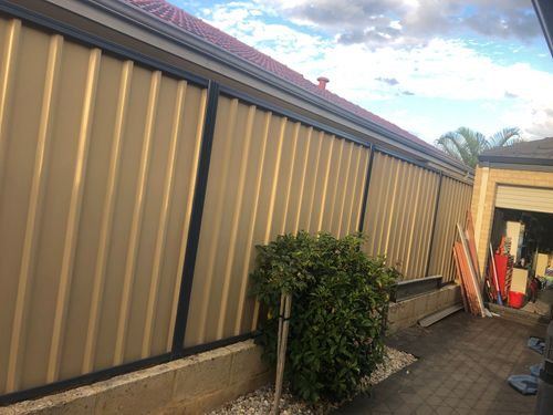

Were you looking to construct a solid frame in this area and cover it with wire netting, or did the bird netting sound as if it might work better? Did you have a look at those discussions I linked above?
I am unaware of any zip-style doors that are designed for cat enclosures. If you were to build a timber frame and doorway for the enclosure, you could use a Monarch 2.4 x 1m Domestic Zip Door Domestic for the opening. Instead of the Zip door, you might find using the existing pool fence and gate easiest. Wire mesh could prevent the cat from squeezing through the bars.
To enclose the top, bird netting is going to be the easiest option unless you'd like to make a solid timber-framed roof. The netting can be attached to the top of the fence and stretched across to the eaves. It can then be affixed to the brick wall above the garage door and the pool fence.

DIY cat enclosure with zip door
12 metre length
x 2 metre width
cat door installed on fixed Panal laundry side
Welcome to the Bunnings Workshop community @pmaci. It's wonderful to have you join us, and many thanks for showing us the area in which you intend to build a cat enclosure.
If you could provide more details about the size and style of enclosure you wish to build, our knowledgeable members would be better placed to offer useful suggestions. Did you want to enclose the whole area from the top of the fence to the house fascia with netting or construct a standalone structure with netted sides? Bird netting could be an effective way to enclose the area as it is lightweight, tough and able to be stretched tightly across the area.
