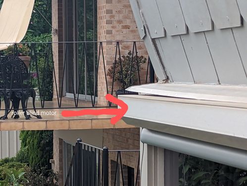

The red arrow is the roller blind motor.
The flashing that covers it is upturned. I need some advice. Should I extend the flashing to cover the entire roller blind.
what material should i use for this project

I'd recommend applying a generous amount of Sika 11FC under the front edge of the flashing and placing a brick on it until the adhesive has set. That would likely solve the issue. You could certainly add an additional flashing if there were some reason to do so, like water was getting up and under the current one; in saying that, though, the Sika will likely seal out any water migrating under the flashing.
