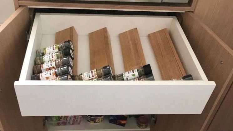

A bespoke spice rack inside a drawer made with leftover timber.
The project
I had some space available in one of my cupboards, so I decided to make this spices drawer. It's a lot better than having spices all over the place.

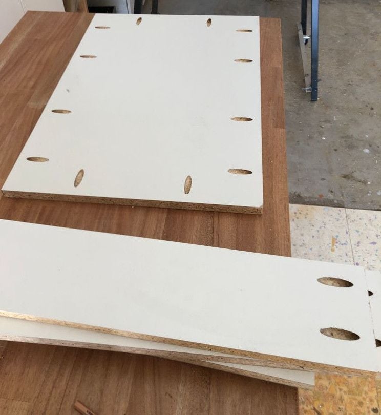

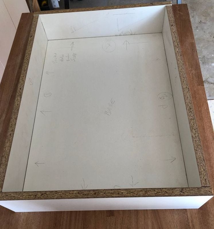

First, the panels are cut to size.
A test assembly with the parts identified in pencil.

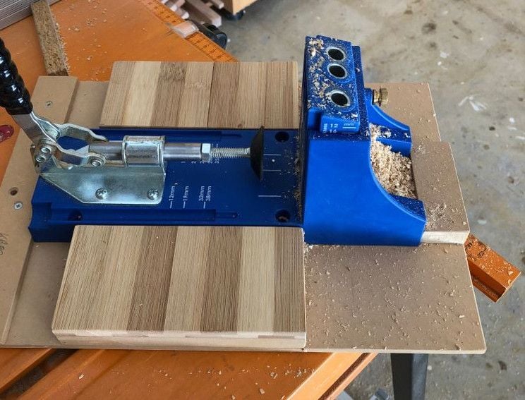

I then used the pocket hole jig for the pocket hole screws.
It did a great job.

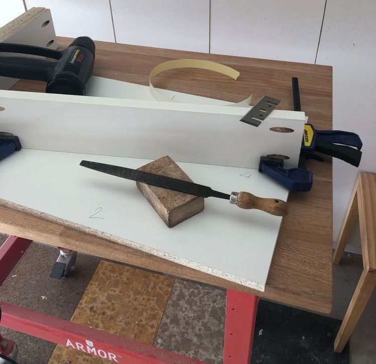

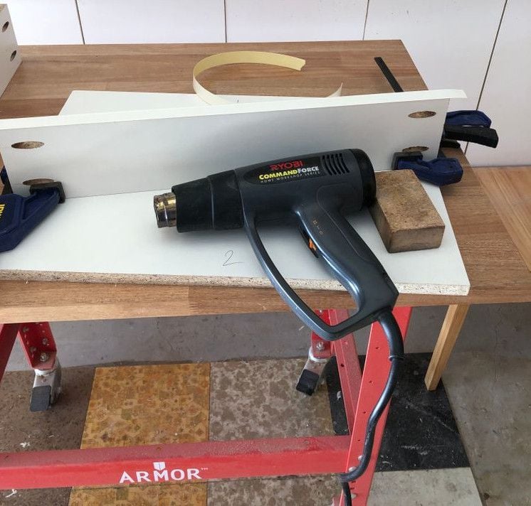

Then I applied the Melamine Edging, using a heat gun and sanding block to fix to the board.
The Melamine Edging is trimmed using an electric plane blade, then file and sand edges.

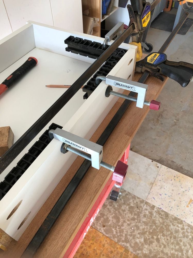

Clamp and screw the drawer using pocket hole screws.

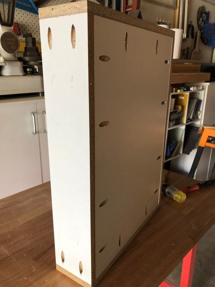

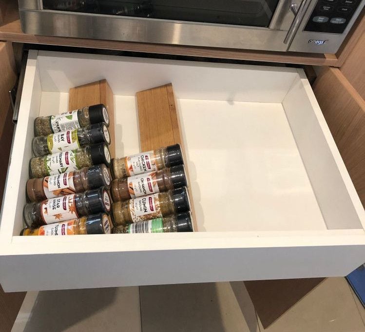

This is how the drawer looked when it was finished.

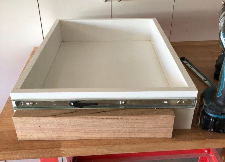

Then the drawer runners were fitted.
The spice jars are elevated using the Tasmanian Oak I had left over. This timber shelving fitted perfectly for this project.
