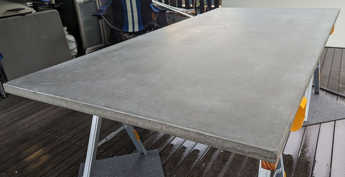

Here's how the tabletop looks after coming out of the form and a quick sand.

Then remove the sides and flip it and remove the top. Sides and top came off super easy.
Then I wet it down and used 240 grit wet and dry to sand it, then 400 grit for final wet sanding.
After that I sealed it using penetrating sealer.
I'm super happy with how it turned out. It's really strong, doesn't have any flex when you lift it from the two ends.
