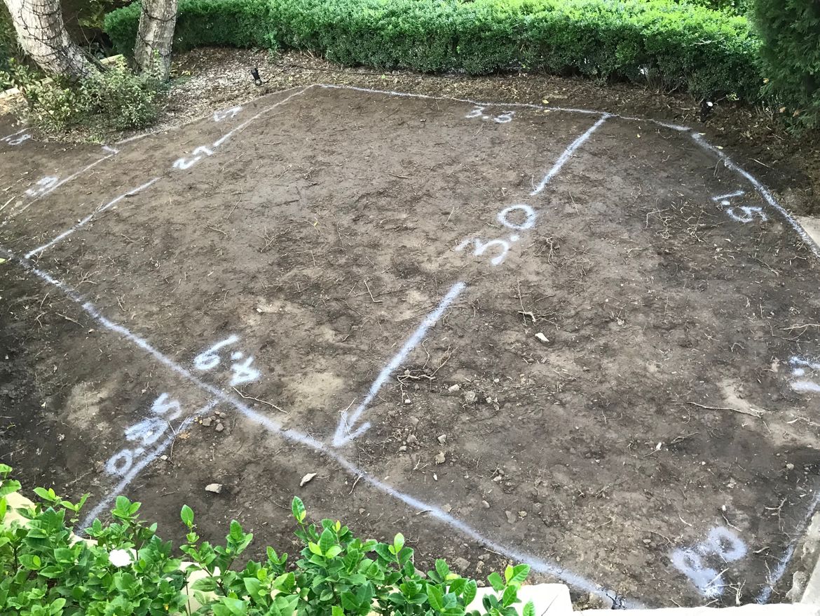

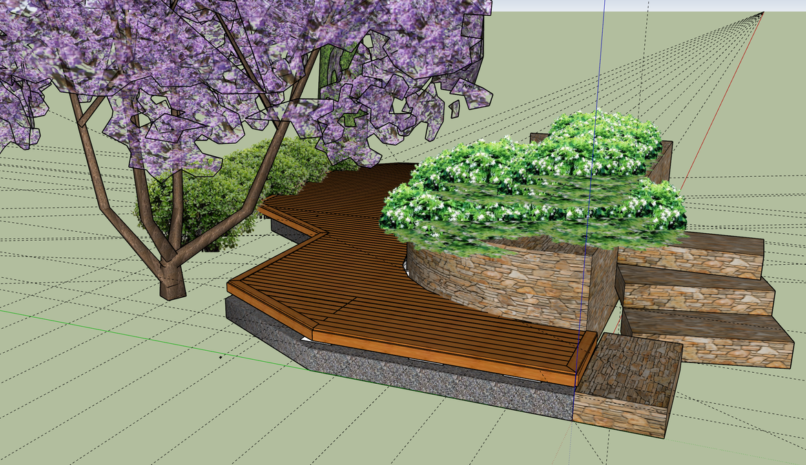

I'm Chen and plan to build a curve decking in my front yard to replace the existing lawn. The area faces north/west and does not receive sunlight well during winter due to the Sun angle and the surrounding trees, the lawn wasn't very well maintained either, hence why I'm starting the project. I've designed the layout in Sketchup and would like to hear some ideas and feedback for my plan.
Plan

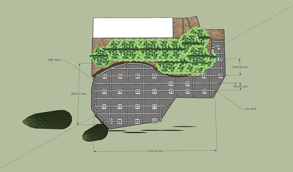

The site dimension is about 7.9m x 3.6m, detailed dimension is in the SketchUp plan down below.
I'm planning to build a floating foundation using decking foot e.g. TuffBlock or similar products. As there's one mature Jacaranda tree and two cypresses surrounding the area, I'd avoid digging post holes and concrete.

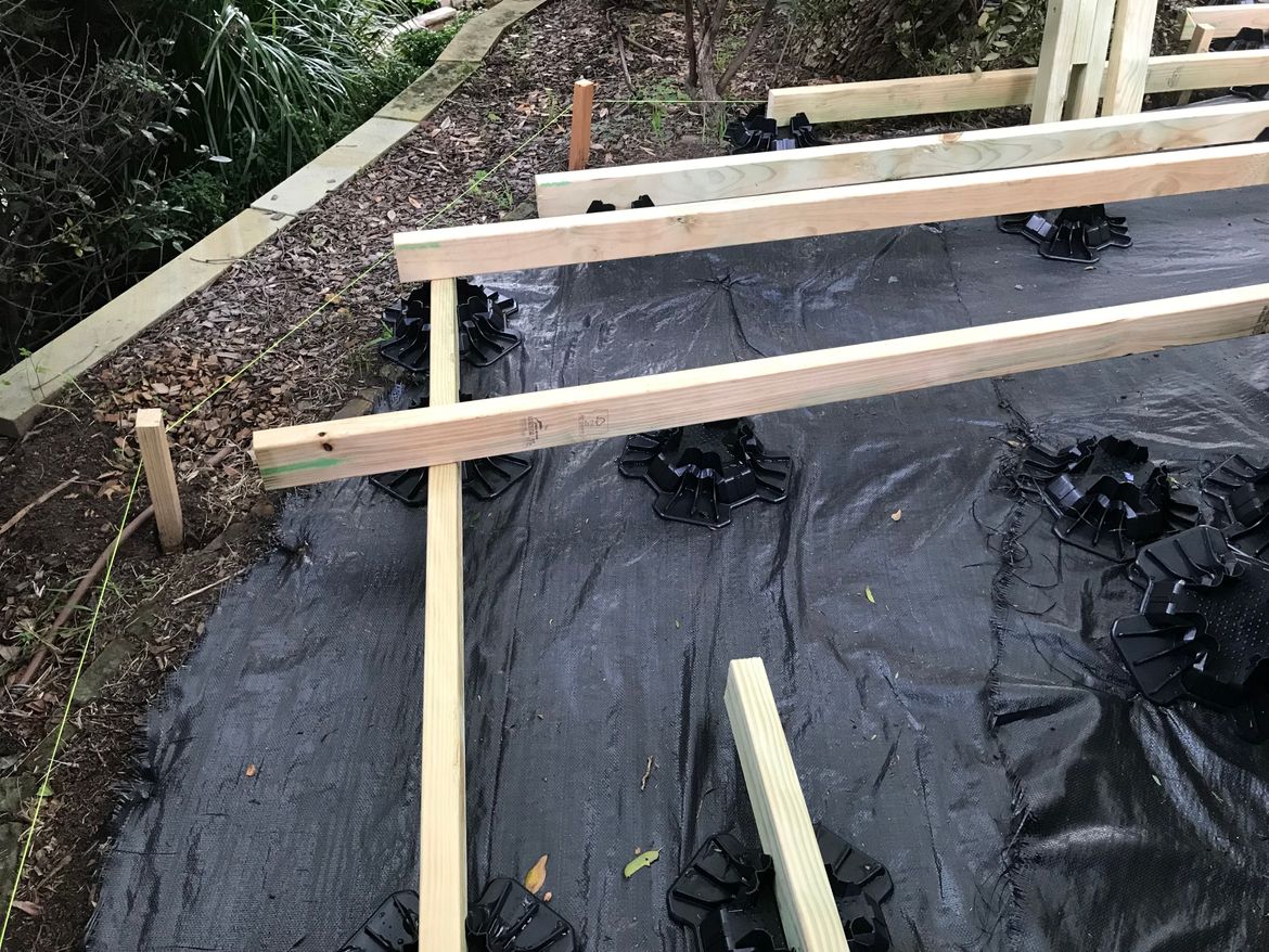

Plan to use 90 x 45 H3 timber for framing with 450mm spacing apart. Decking foot will be laid 1000mm apart.

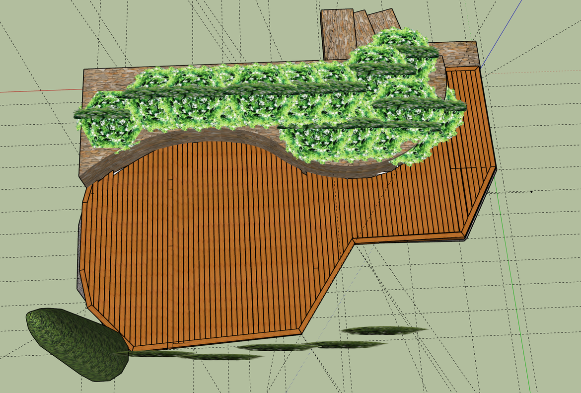

The project will require quite a bit of cutting to fit with the curve side along the garden bed. I will picture frame rest of the edges.
Subframe
Decking board laid
Bottom view
Flow to existed pathway

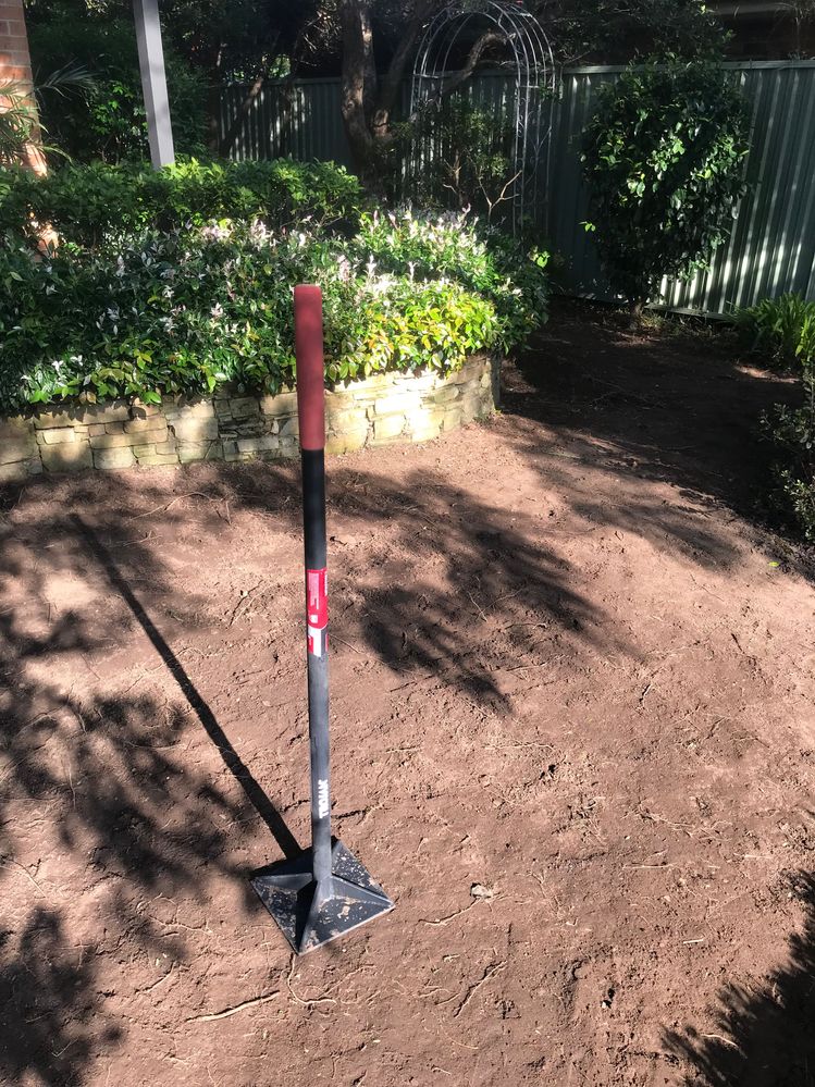

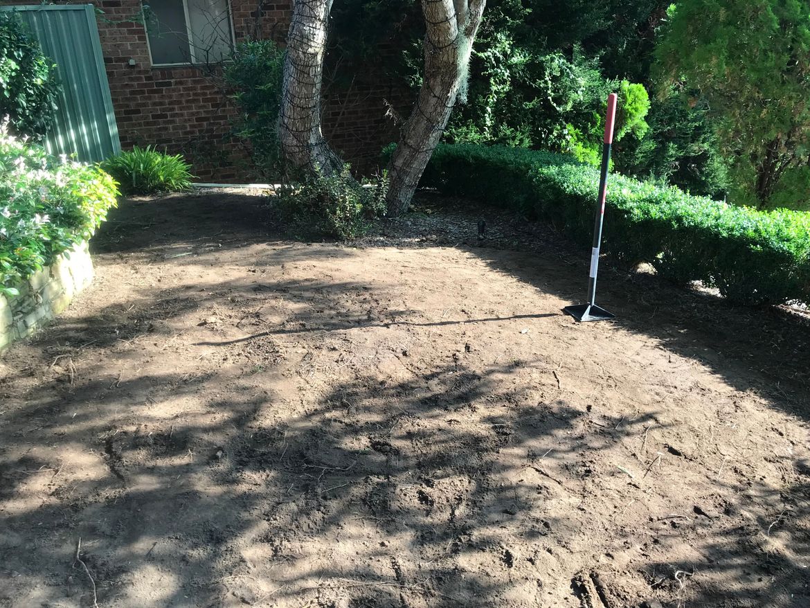

I've stripped grass, leveled the soil, and compacted with a hand tamper. Next step is to lay some weed mat and road base for decking foot to set on.
