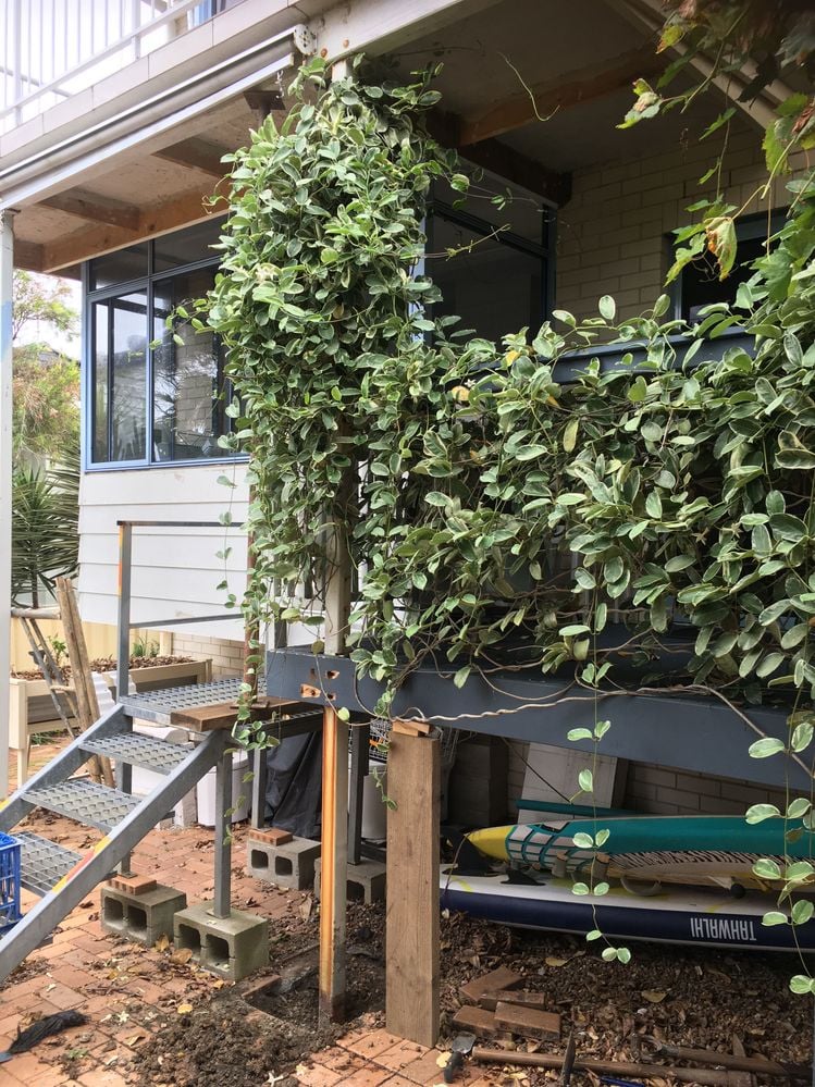

I am in the process of replacing steel posts supporting tiled verandahs with timber posts (90x90 cm Merbau). We are located close to the coast so the steel is rusting where fixings for hand rails etc. have removed the galvanizing, hence the change to timber. I have several questions:

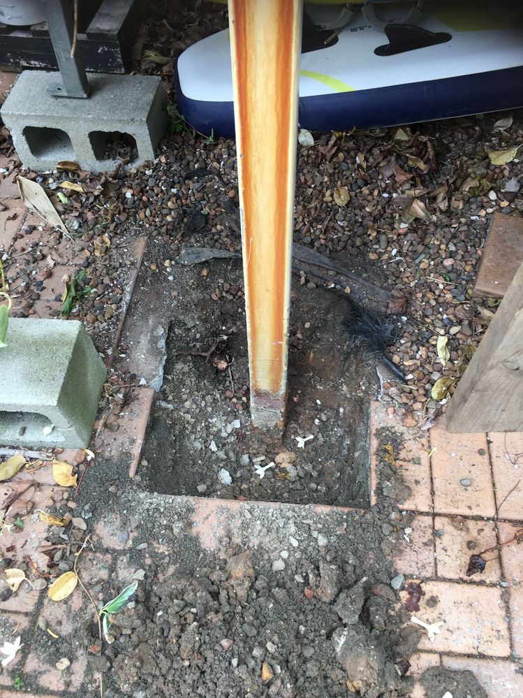

I have had to excavate the buried post in the photo as they were buried during some yard work. My plan is to excavate to the top of the concrete pad and add the 30cm or so of concrete to the top of the pad so the new stirrup and timber post are well clear of any soil. i have questions about this:
1. Should I drill holes in the old pad and put 4 (?) pieces of steel rio, old bolts, into the holes to tie the new concrete to the old pad.
and bondcrete the top of the old pad

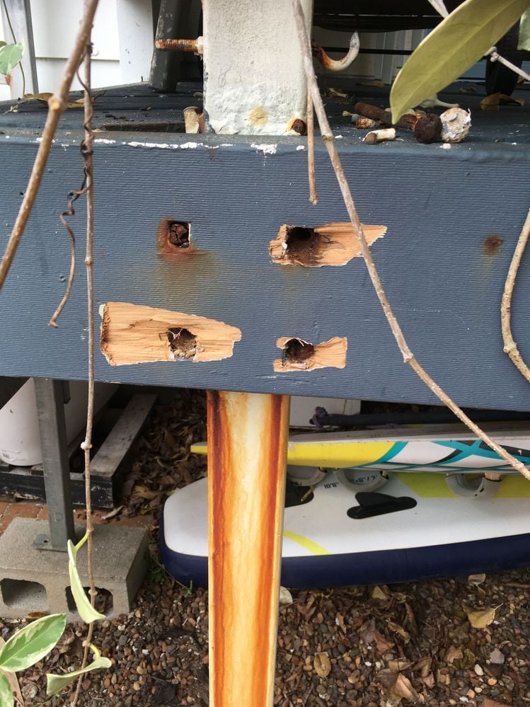

2. Is it OK to screw the bearer to the Merbau post (the photo with the old bolt holes in it) or will it weaken the post?
3. The old steel post is bolted to the old concrete pad. Can I leave the bottom 15cm of post in the hole when I fill the hole with new concrete, or am I making it vulnerable to rusting in the new concrete ( concrete cancer)?
