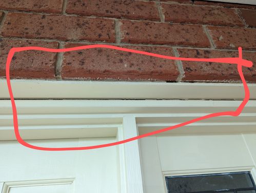

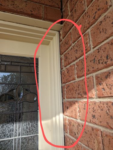

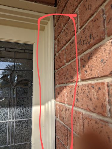

Can you please provide guidance on sealing the gaps between door frames and walls.
This is for exterior door frames and walls.
Hello @mmw08
I suggest using Selleys 430g White No More Gaps Exterior Gap Filler. It is weather resistant, can fill a gap of up to 25mm and can be applied to various materials.
I recommend washing the area very well with Selleys 1L Wall Surface Cleaner Super Concentrate Sugar Soap to remove all the dust and debris on the surface. Once the area is dry, you can then apply the gap filler.
Please make sure to wear personal protection such as gloves, goggles and a mask when repairing the gap.
