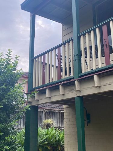

What timber should I use for an old houses 120 x 120 verandah post to replace the existing hardwood one
the corners of the post will need to be chamfered to match the existing then painted dark green

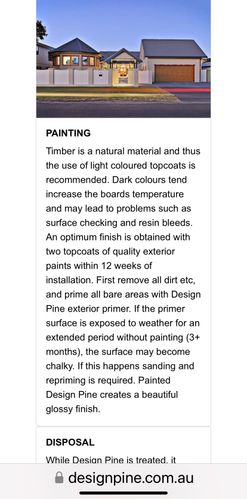

I see all the FJ /Laminated treated & pre primed pine posts say they should be painted in a lighter colour , and I don’t know how they stand last with any kind of machining/chamfering on the corners etc with the finger joins and treatment
