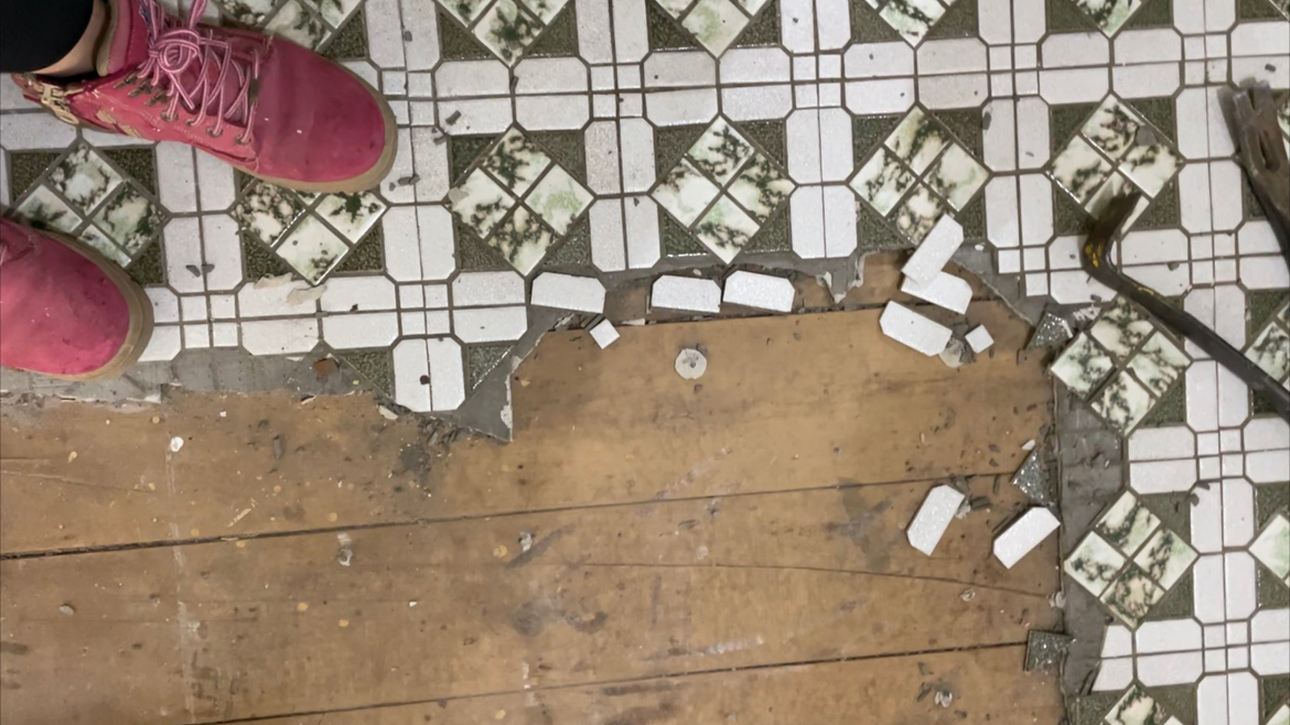

We had tiles over our floors, we knew there was wood underneath the tiles, but we had no idea what condition they were in. We spent the better part of a day removing the tiles, which had been installed over concrete boards, allowing us to remove them in sections and save the wood. Once removed and cleaned up we used a pry bar to remove the remaining nails in the floor. And it was beautiful so we did a happy dance and then planned for the next day.

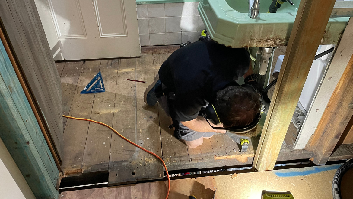

There was a slight height difference between the original house and the extension, so we needed to build up the floor to level it out, there will be a slight slope, it’s so slight you wouldn’t notice it but if you don’t build it up, then you’d have different heights.

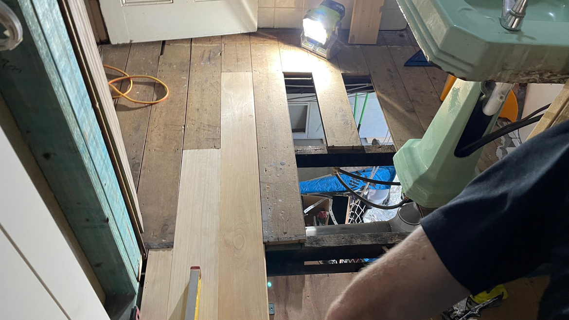

Stagger the original flooring

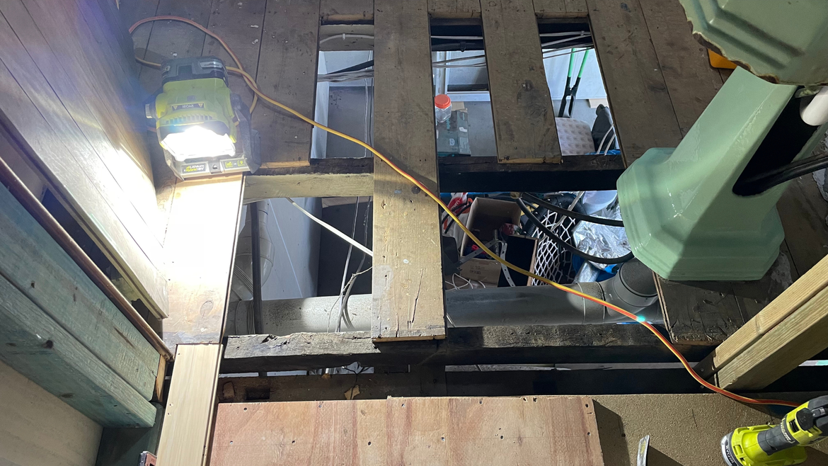

Using a multi-tool Derek cut into the original wood, on the joist. We need to ensure the new wood and old wood are able to be fixed to the joist so cut at the midpoint.
Clean out the old joins of the wood, there was over 100 years of dirt in ours, and you want the new wood to slide in nicely. It needs to fit tightly but you don’t want to split the wood.

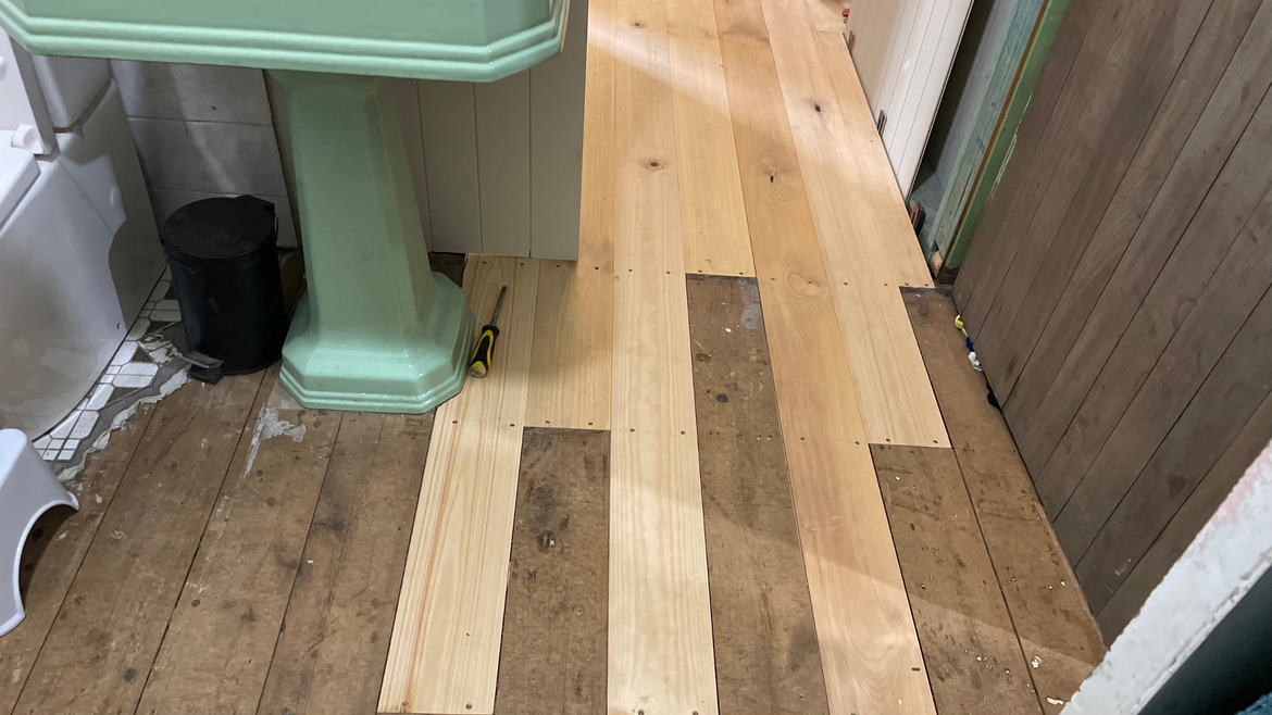

Install new wood
Spread liquid nails evenly along the floor where your piece of flooring will go. Using some offcut to protect the wood we carefully drove the newpiece of flooring into the gap of the old flooring. By holding a piece of offcut to the end of the wood we could hammer the wood inplace without damaging the board.
One of us hammered the wood into place; The other person guided the wood in place.
Once in place we used a nailer to nail the wood to the floor.
We predrilled holes in the wood where it meets the old wood, you can’t get the flooring nailer into place. We added screws to reduce movement and lifting. These will be filled when the floor is stained.
And that’s it, we repeated this process until the hallway was finished.
I know it doesn’t look like much now but once the floor has been sanded the variation in colour will be less obvious. And as we have chosen a darker stain this will help minimise the difference.
