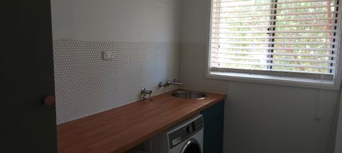

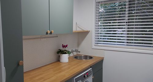

Once all of that was done (as well as painting ceiling, walls, window and door trim), it was time to get the cabinetry in. I went with Ikea cupboards because I like the system they have for hanging them, I loved the colour of the doors and of course the price was good. The base cabinet for the sink went in first, then the broom cupboard. Once that was in, we cut the laminate benchtop to size, cut out the hole for the sink and installed. I had decided that to save on costs, I would keep the plumbing in situ for the washing machine (we cut a hole in the benchtop to accommodate the taps) and keep the power point above the bench for easy access when ironing. A pot plant strategically placed hides the taps when you look in from the door.

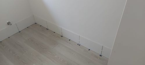

It was then time to tile the backsplash - I went with white matt penny round tiles. I love the look of them, but they were a pain to grout and silicone 🙂 Being on sheets they were pretty quick and easy to install though. It's not a perfect job but I'm happy with them.

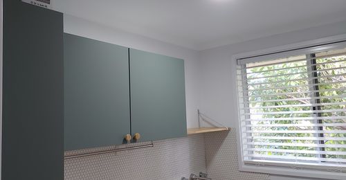

The only thing left to do then was install the wall cupboards and the shelf, and replace the ceiling light (thanks again to electrician son!) and a few finishing touches. All up the total cost was around $2000 (it helped that I didn't need to pay for any trades!) and now I'm proudly showing my laundry off to everyone who comes to visit, rather than previously closing the door and hiding it!
