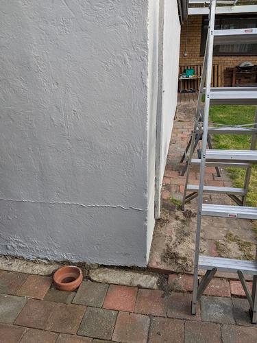

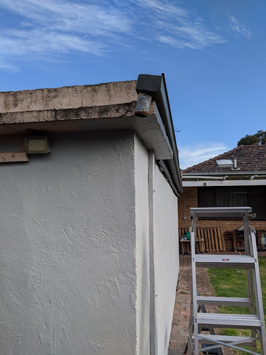

I need to install something to catch the water that comes off our garage roof and have it run to the drain next to our garage.

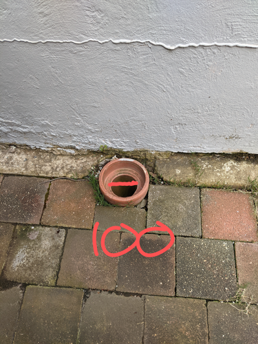

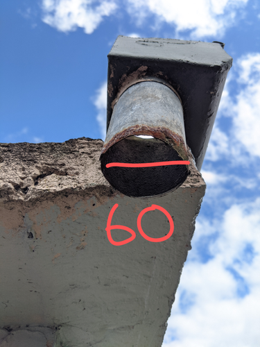

Currently the guttering has an round (60mm across) outlet and the drain is terracotta with an opening of 100mm across.
I'm wondering if I need to attach something like this and then run some PVC pipe (round or rectangular) down to the drain. If so, how do I go from 65mm at the top of the pipe down to 100mm at the bottom? Should I use square or round PVC?
