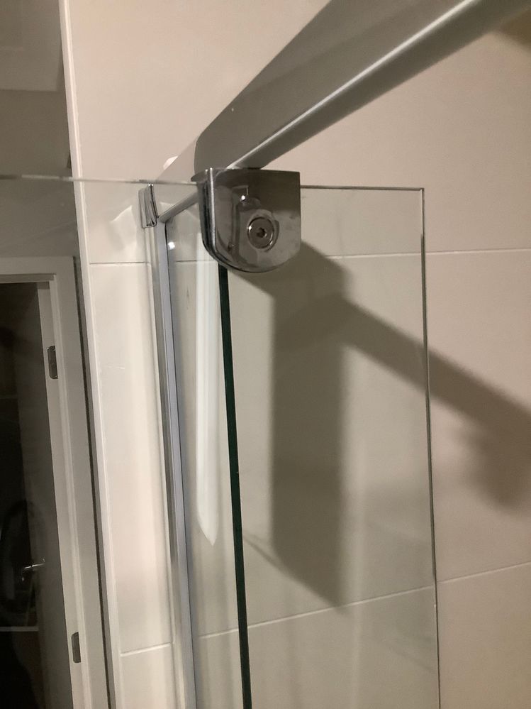

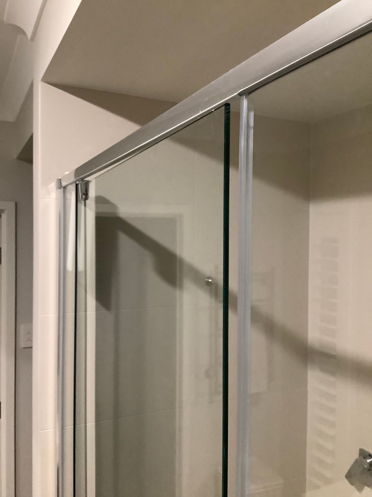

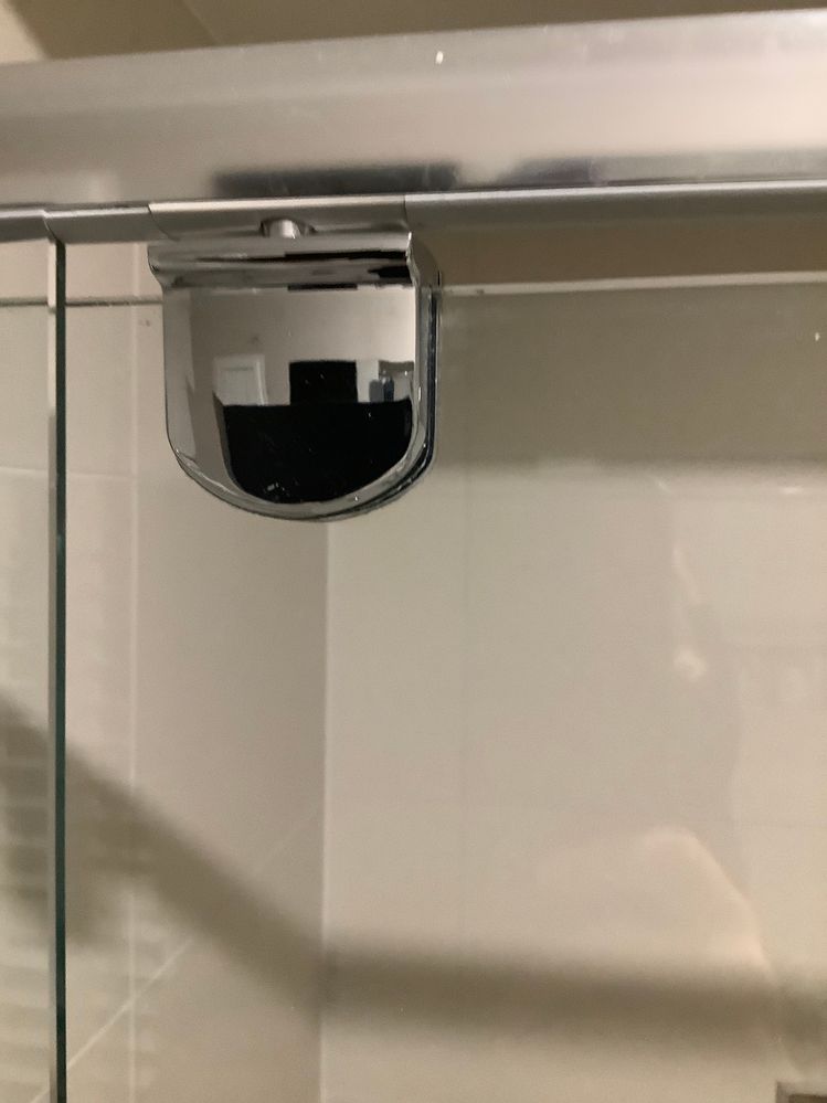

My shower door doesn’t close fully, leaving a gap. It has a pivot at the top and bottom, what do I adjust to make it fully close?

Are you able to push the door closed, or can you not physically close it at all @Ward3? Is it just that if you move it to the closed position, it self-opens with that gap? Many hinges include a small detent mechanism inside that holds the door in the closed position. If this function is not working, then the weight of the door will cause it to open to the position of least resistance. If this issue has become worse over time, this internal mechanism has likely worn out.
If the above is correct, there's nothing to adjust to fix the issue. You'd be looking at replacing the hinges from the manufacturer or trying to figure out some type of latch system. You could possibly silicone a magnetic door catch to the top corner of the screen and door. Hopefully, the holding strength would be enough to keep the door closed.
