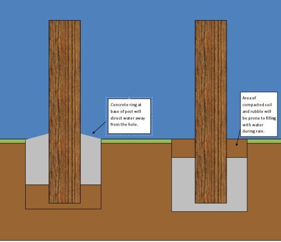

@jeffl_auremoval of that top 50mm of soil would make a big difference, as the water is probably soaking in to that top 50mm and then running down the slope. Removing the top 50mm, will also remove most of the grass/weeds and prevent them from growing back, especially with a bit of gravel. The gravel will prevent the soil underneath from being washed away and you won't see the water sitting/flowing.
For best result, don't put down the gravel until the posts are in. Make sure there are no low areas next to the post, where you have compacted the soil down next. You could use compacted soil to create a slope around the post, it doesn't have to be concrete as shown in picture.
50mm is enough for the water to seep in, as @RSS has mentioned. It would always be best to have drainage to collect the water, but at a minimum, gravel is needed so pools of water don't splash back up and onto the underside of your decking and joists.
