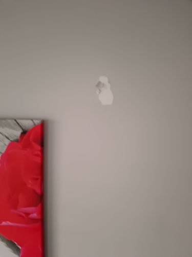

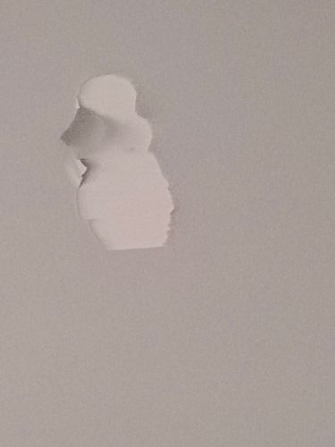

Was putting up a picture in my lounge using picture hooks and managed to rip off the paint while readjusting the frame.
How do I fix this wall?
Hello @Ligey
Welcome to the Bunnings Workshop community. It's marvellous to have you join us, and thank you for sharing your question about patching up a paint rip on your wall.
The adhesive on those wall hooks can sometimes be very strong, potent enough that it rips the paint right off. I suggest taking a small sample of the paint that has been ripped off, about the size of a ten-cent coin. You'll need to bring this sample to the stores paint department so that they can colour match your paint.
The next step is to sand the damaged area with a 240 grit sandpaper in conjunction with a Paint Partner Cork Sanding Block. Sand only the damaged area just enough to remove the loose parts of the torn paint. If the paint layer is noticeable, it might be necessary to apply a thin layer of Poly 100g Plaster Cracks Filler.
Once the filler dries you can then sand down the area so that it is in the same level as the wall. Clean the area very well with a clean damp rag. Let the area dry off before you paint the repair coat.
