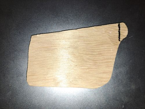

The gutters on my granny flat are rusting thru so I'm looking for a way to repair them.
I've used Icon Plastics 2.4m PVC Cloudburst Gutters on a aviary:
https://www.bunnings.com.au/icon-plastics-2-4m-pvc-cloudburst-gutter_p477012
This PVC gutter will fit in the existing metal gutter except for the outside edge, see the marked section on the photo below of an end cap mock up.
Originally, I thought about modifying all of the PVC gutters before inserting, but I might be able to bend them and only modify the end piece & end cap. (As long as they don't get hung up on the exising hangers)
I'm still thinking about how to connect to the downspout.
One thought it to insert PVC gutters all the way to the downspout and just let them flow into the downspout.
But, water can flow back under the PVC gutter and out the holes in the metal gutter.
I could seal the PVC gutter to the metal gutter by the downspout but would need to use something like "Selleys All Clear" since the metal gutters are rusty and grimmy.
But, I'd rather not use a strong chemical sealent since the gutters feed a drinking water tank.
All thoughts appreciated, thanks!
Gutter end cap modification
