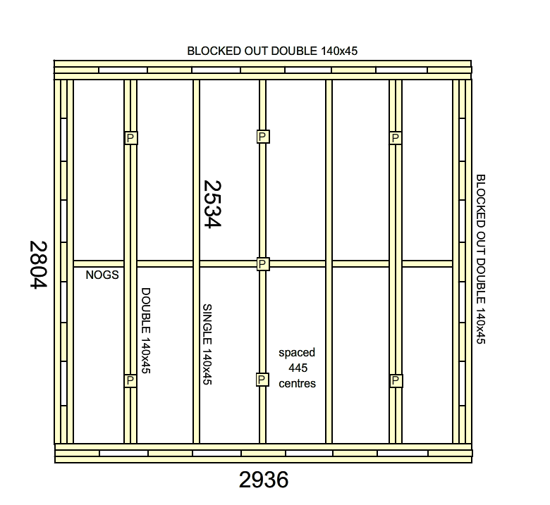

The home owner wanted it to be about 3m x 3m. Since I wanted to minimise wastage of the expensive Ekodeck, I came up with the below framing design. The double blocked out edges allowed me to picture frame all around the deck. The double and centre beams had the posts under them as the supporting beams.
For this job I also had to remember that I was adding a gazebo - so additional noggins were required to make sure I could attach the gazebo through the deck to the framing for sufficient strength.
Also remember you'll need to have the decking overhang the frame by 25mm all around if you intend to add fascia boards to hide the frame.

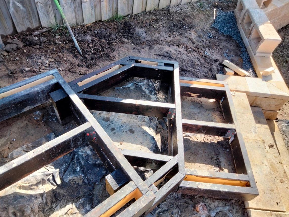

Step 2

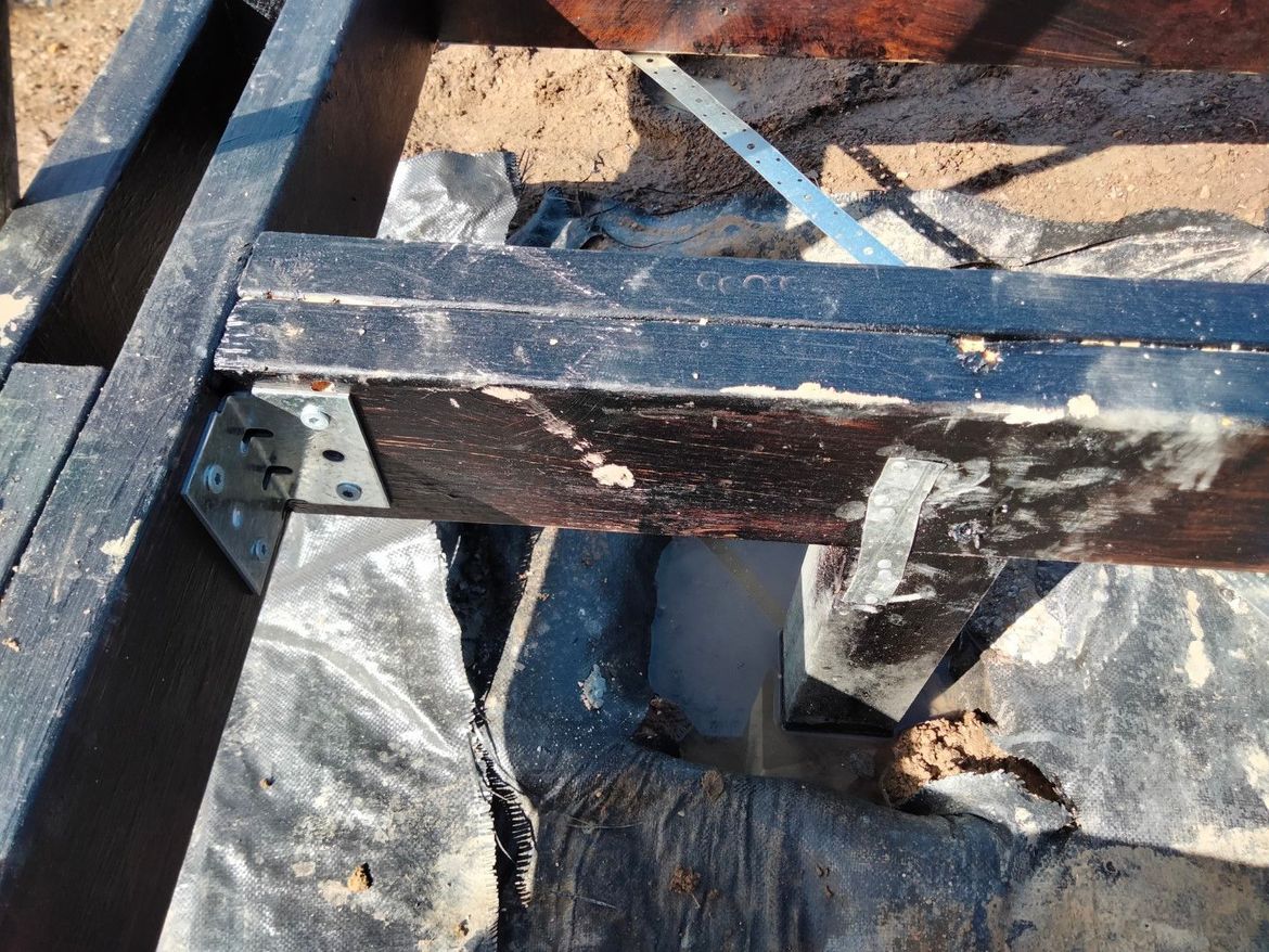

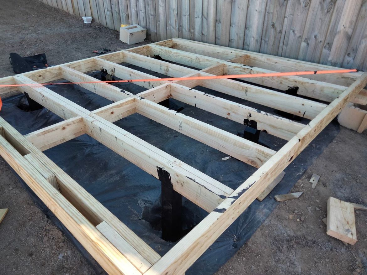

For single layer framing, I find it easier to build the frame first, prop it up to get it perfectly level, then hang the posts in holes and concrete it in. Here I've built the frame using nails as well as 150 and 175mm battern screws (hangers and angles will be used later to reinforce all joints). Note the weed mat and the posts hanging in holes. I painted the posts with bitumen to give them additional protection. The ratchet strap is to hold it perfectly square while concreting - galvanised strapping was later added during the reinforcing stage.
Step 3

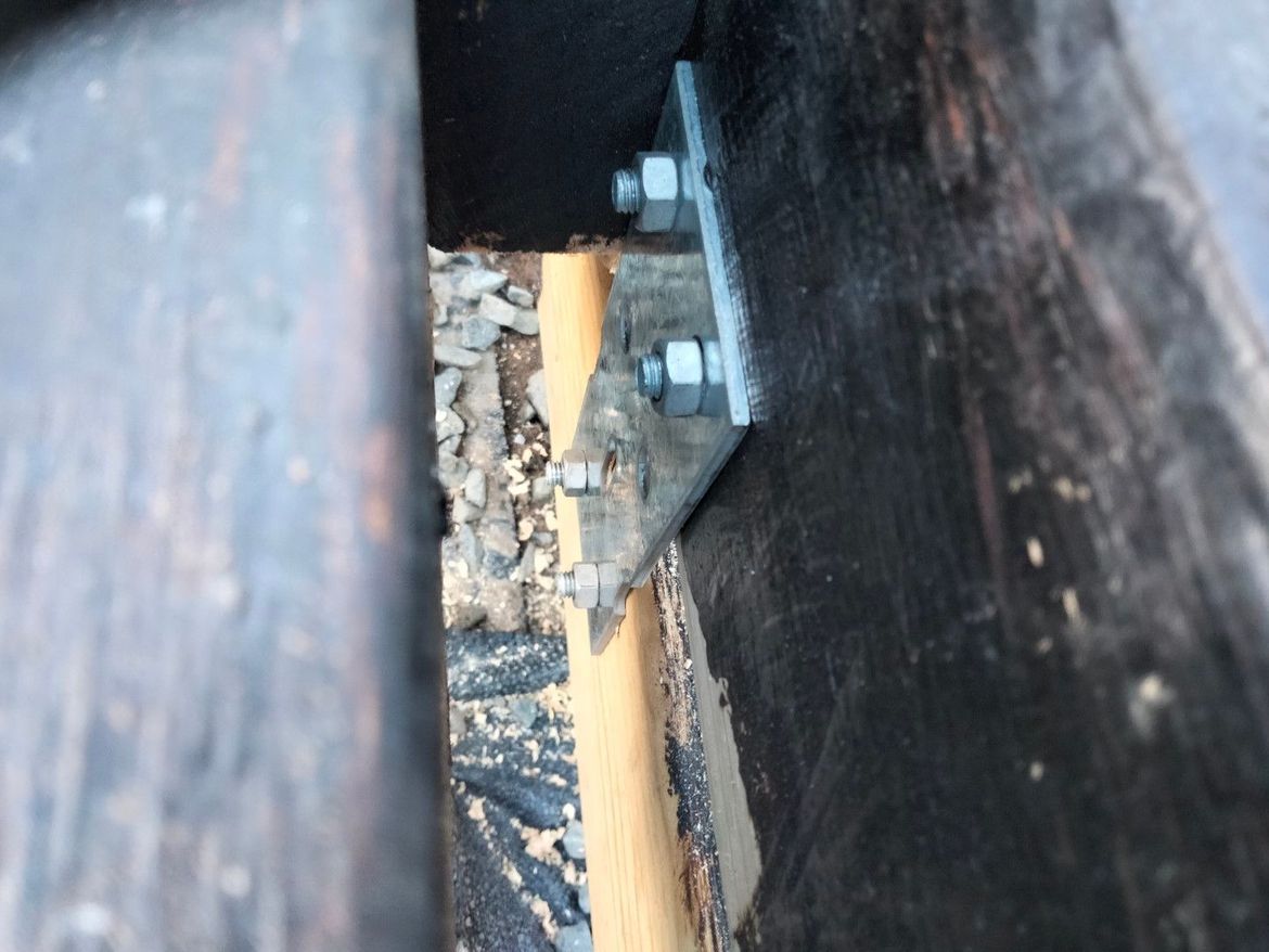

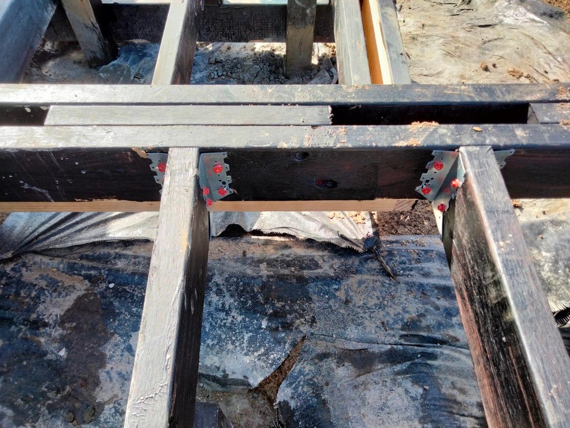

One the concrete was poured, I added glavised brackets to reinforce the frame, diagonal strapping to keep it all square, and joist hangers where appropriate. I also painted the rest of the frame black, as it looks much better with the ekodeck than naked timber underneath.
The orange screws are Pryda joist hanger screws - much faster and easier than nailing in the hangers!

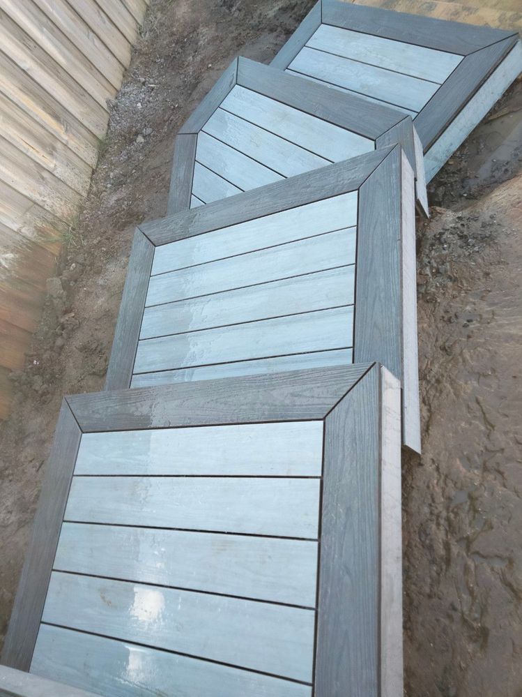

Step 5
Then it was time to lay down the decking. Since Ekodeck expands with heat laterally, you need to have 6mm expansion gaps at all ends - which can get a bit fiddly with the mitres on the dark picture framing. One thing to note if you want to do this - the EkoDeck Edge Boards are held down with hidden C-clips (you'll know what I mean if you use them). The Quickfix Kits that Bunning sells contain no where near enough C-clips - 14 are provided, but I needed something like 70 for the picture framing. Thankfully you can buy them separately.

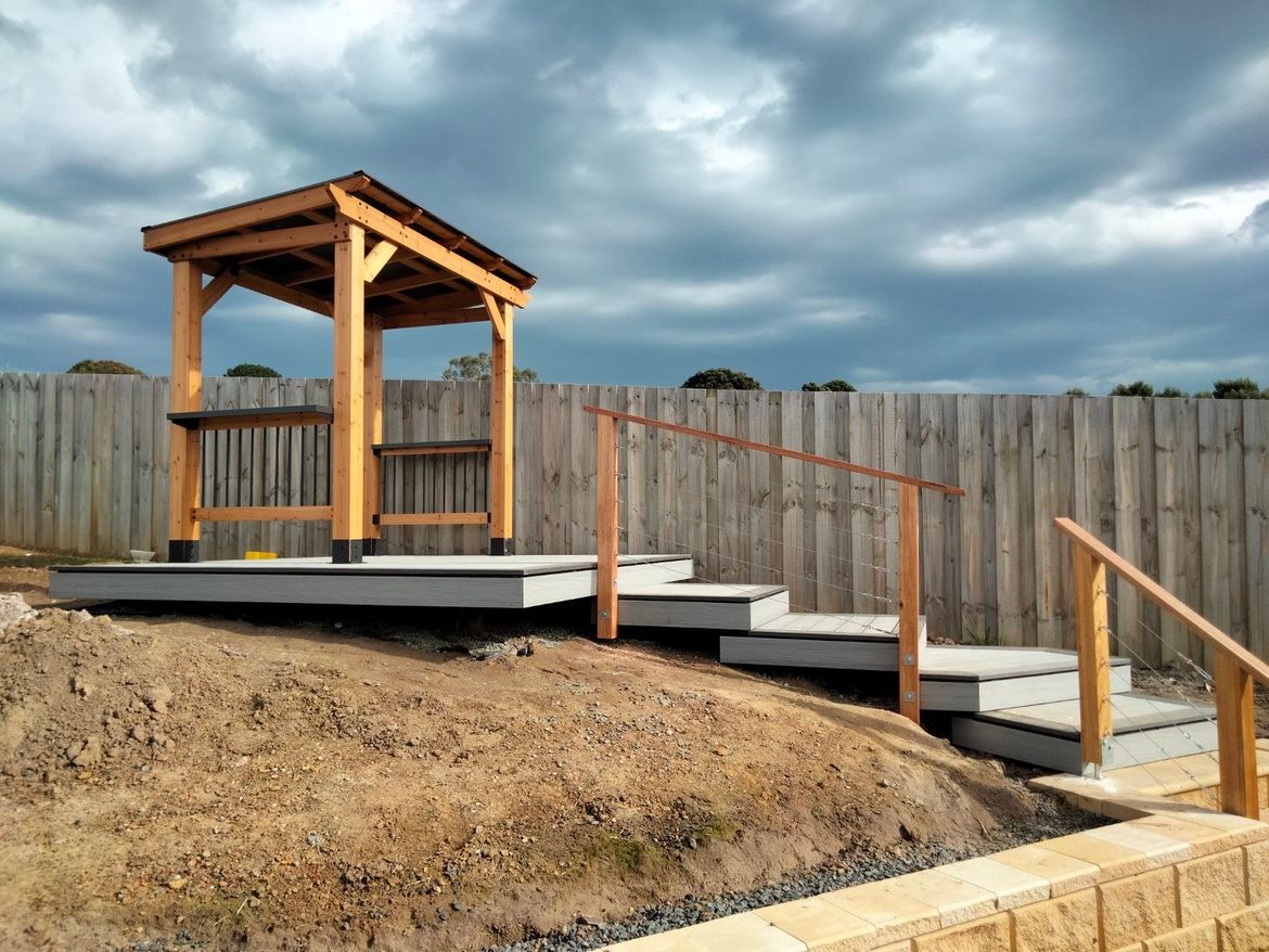

Step 6

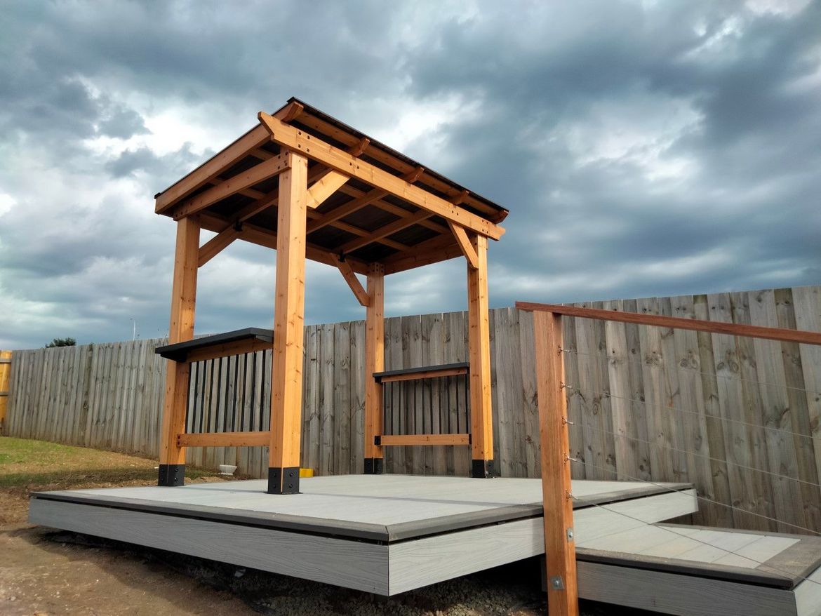

The Saxony Gazebo was easy to build, taking me a day solo, including giving it a coat of marine varnish. It includes 50mm concrete screws if you are fixing it to a slab, but I used 100mm battern screws to fix the steel feet through the deck into the framing, making sure it wont be going anywhere!

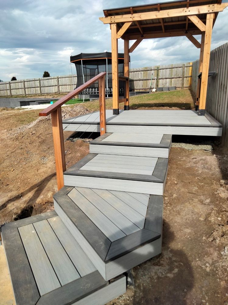

Step 7
Then it was time for the last step, adding in the handrails. These are not required by code as the deck is less than 1m high, however the elderly homeowner requrested them for ease of access.
Because the stonework early had been done, I had to use post brackets to on the first rail to support them. The brackets have a little flex in them when not supported otherwise, so I connected them directly to framing where possible (note the lateral bolt going into the wall halfway up the first post for extra strength). The stainless steel ballustrading wire was not required by code, but is a nice addition.
The last handrail was connected directly to the deck frame with M12 bolts.

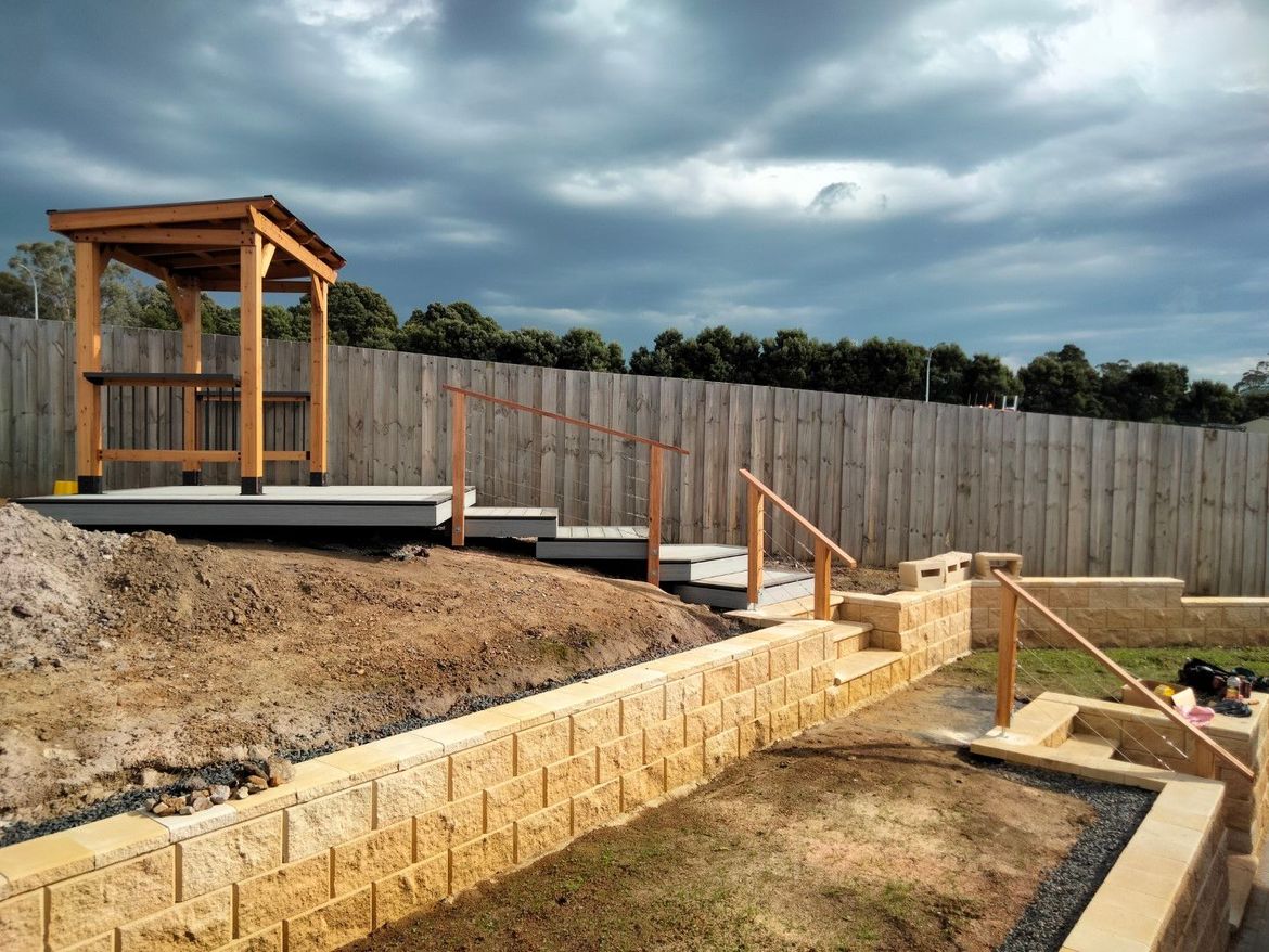

Step 8
And she's done, ready for the landscapers to come in and plant around it! Thanks for the guidance and help I've received from these forums in the past and I hope this post helps someone else down the way.
