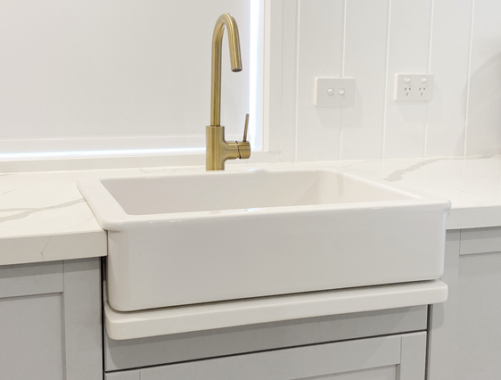

A drip ledge added to a farmhouse sink.
The project
A simple, inexpensive and decorative addition to a farmhouse sink. A drip ledge (also called drip edge or drip rail) serves both form and function by giving a custom look to the kitchen sink, while also protecting the lower cabinetry from water drips.

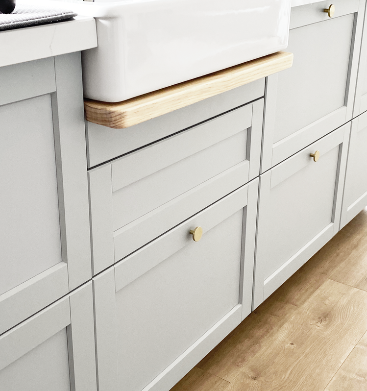

Cut the length of pine to the width of the sink and lower cabinet (600mm), then transfer and mark the profile of the front of the sink onto your timber. We ensured that the width of timber allowed for the drip ledge to be 15mm proud of the sink apron.

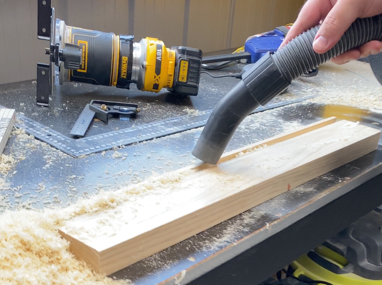

Then I routed a channel on the underside of the drip ledge for mounting onto the filler panel below the sink.

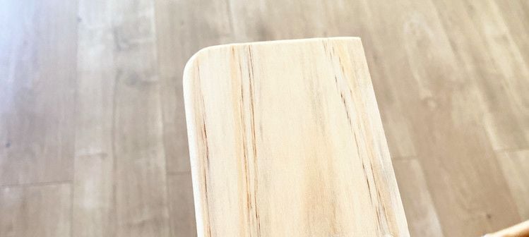

Next, I cut the radius corners and routed around the edges.

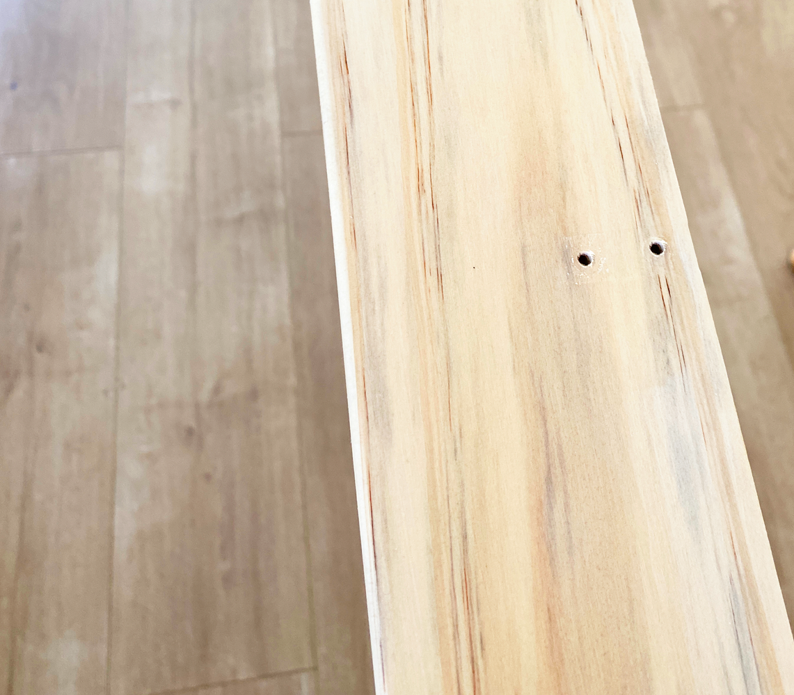

Then I removed the sink and pre-drilled holes into the drip ledge, carcass, and filler panel below the sink. I could then test fit the drip ledge with the angle brackets.

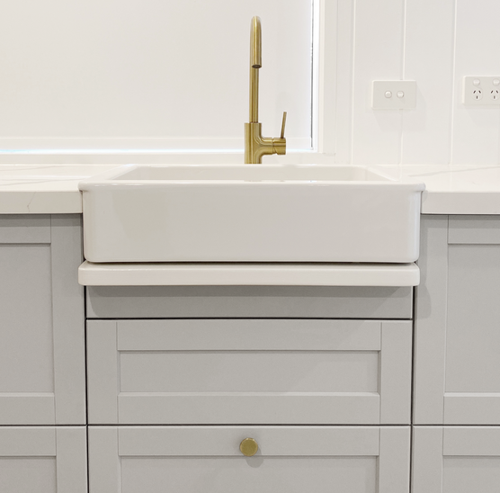

We screwed the drip ledge to the sides of the sink carcass, as well as the filler panel below the sink, using the angle brackets.
Step 10
Then we reinstalled the sink and used silicone around the edges.
