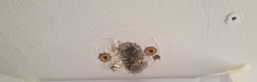

For my ceiling, the lights were removed and left a small 3cm hole that requires fixing for plaster glass ceiling. Do I only need to use the wall patch (https://www.bunnings.com.au/builders-edge-100-x-100mm-plasterboard-wall-patch_p0730622) and paint after?

In regards to your plaster glass ceiling, would it be possible for you to post a photo of the hole in the ceiling. This will give our members a chance to assess the type of ceiling material that you have. We can then make recommendations on how to repair it.
Hi. Sorry for the late reply. Attached is a picture of the ceiling.

You can use a general-purpose filler like Poly 100g Plaster Cracks Filler on all the cracks and this hole in the ceiling.
Did you want to remove the fittings, or were you happy to just paint over them, like the one to the right of the image?
Given that this ceiling board has fibres, you should treat it as containing asbestos. It's likely not, but better safe than sorry. Remember your PPE, including safety glasses, gloves, disposable overall and a respirator. For more information on asbestos, please check out our Best Advice guide on Where you might find asbestos in your home.
