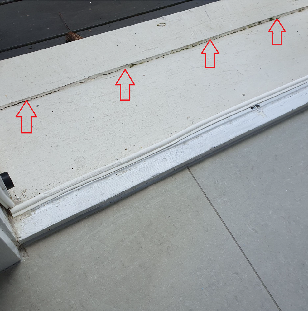

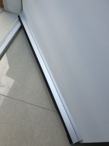

How else can i stop water from coming in through my front door from underneath. I have door seal on my door which was done recently.

The only way I can think of to stop that water from sitting there is to adjust the threshold so there is a slope @Renes. Alternatively, you could look at one of the canopies that I mentioned earlier.
The water actually sits on the raised timber (where i placed the weather strip)not where the arrow was pointing. Water sits right under my door which is why when i opened the door, the door stopper kind of brush off the water on my door sill into my kitchen floor.
A groove isn't so much of an issue as it won't cause water to pool on the whole threshold area @Renes. What happens if you pour water on the flat timber area? Does it run off quickly or just sit there?

I just had a look at the arrows pointed by u in the picture, is actually a groove not raised. Is there anything i can do about it?

This raised section is stopping the water from flowing away, and unless it can flow around somehow, it will form a pool. In high winds, the pool of water will be blown back under your door. You need to try and remove this raised section to allow water to escape more easily. Can you tell if this is a separate section of timber that can be removed? Perhaps you could sand it down with a belt sander if you had one available.

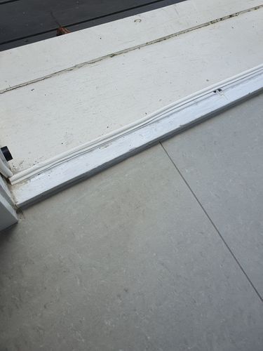

When there s rain , the water tends to sit on the door sill so when i opened the door the water will come through....with the severe storm, i could see water come through under the door when i was inside. I don t think my door sill has a slope.
Can you tell where the water is coming in @Renes? Are you sure it's entering under the door between the two seals you've placed there and not through the door sill, as indicated below? If water is pooling on the door sill's exterior, it could penetrate under the timber instead of under the door. It looks like there is a bit of a catchment zone outside the door sill, with a raised section of timber about 20cm away from it. Does water build up in this area? A door sill should be sloped away from the door so any rain that lands on it can run off in the opposite direction to the door.
Thanks for replying Mitchell. I hv attached some pictures..hopefully u can give me some ideas. I just put on weather strip as u can see in the picture. So i m not sure if it helps.
