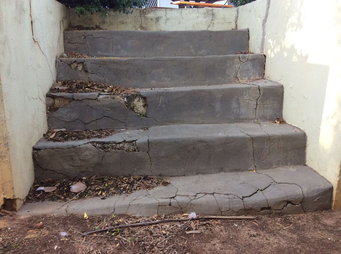

I moved here last year, these steps are not fit for purpose unless you are over 6 feet tall.
any advise on how to change them would be appreciated.
the steps are made of limestone covered in concrete, as you can see from the photo it is starting to break down. I can’t bring them forward as it is on the boundary.

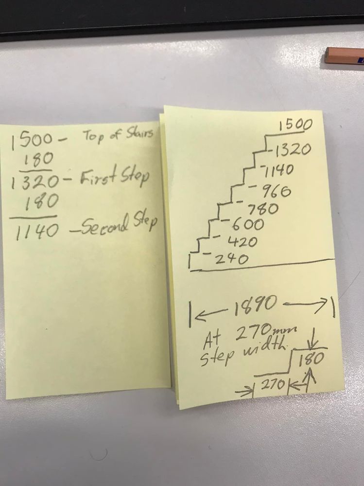

Tread widths
Top down 26cm
1st step width 37cm
Down 26cm
2nd step width 35cm
Down 27cm
3rd step width 40cm
Down 29cm
4th step width 37cm
Down 26cm
5th step width 40cm
Down to ground level
sloping 0 to 15cm
