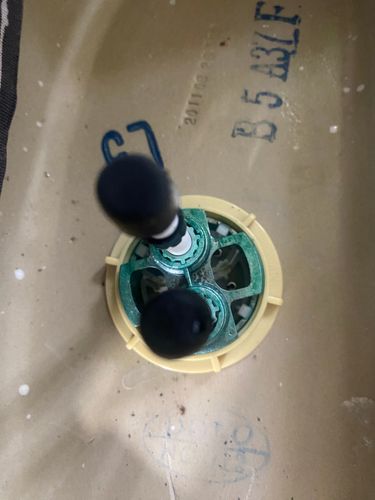

It appears that you might have a Fluidmaster 48mm Dual Flush Round Cistern Button. I believe you should be able to lift the cistern lid straight off to access the nut on the underside of the buttons to remove them. Is it just the buttons you wish to replace to improve their look?

That Round cream colored ring should unscrew anti clock wise.

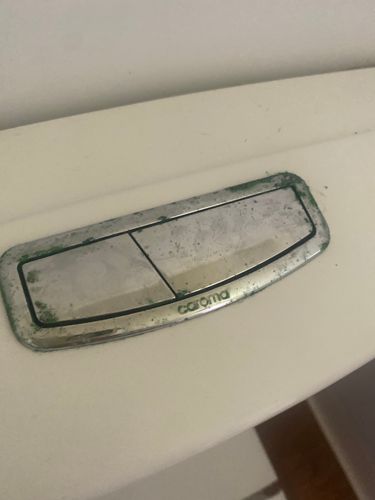

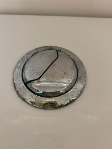

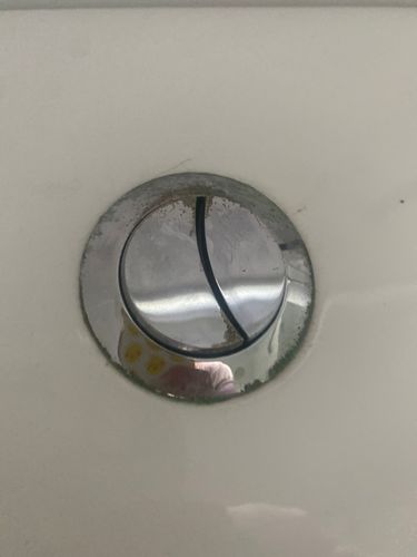

Thanks so much, we will double check sizes etc but any guesses what these two would be?
There is a good chance that the first circular button can be replaced with either Fluidmaster 38mm Dual Flush Round Cistern Button or Fluidmaster 48mm Dual Flush Round Cistern Button. However, the second rectangular button will be harder to come by, and I am unaware of a replacement part. In this situation, you'd typically replace the whole cistern. You might like to speak with a helpful team member at your local store's Special Order desk. They can check with Caroma to see if a replacement part is available.
