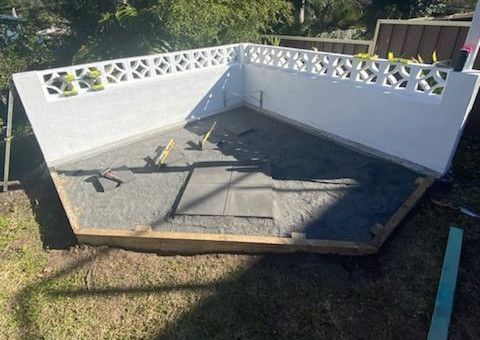

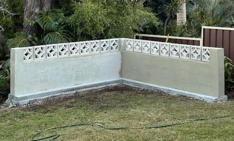

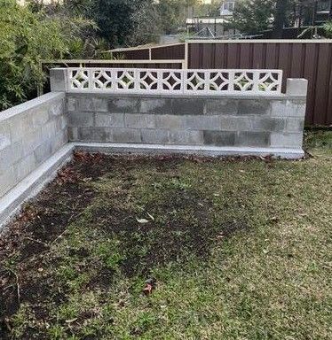

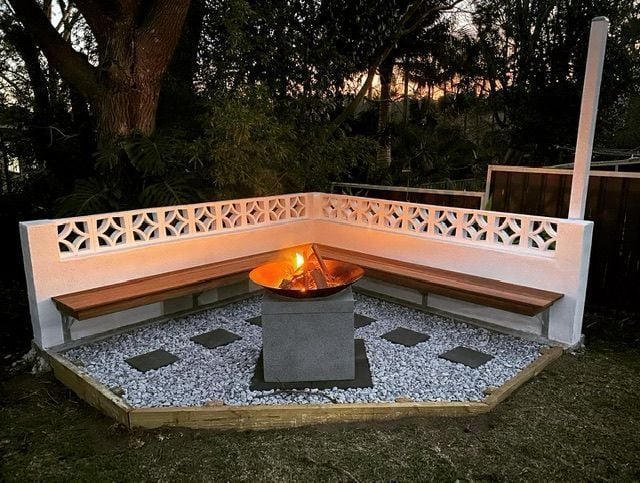

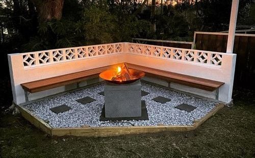

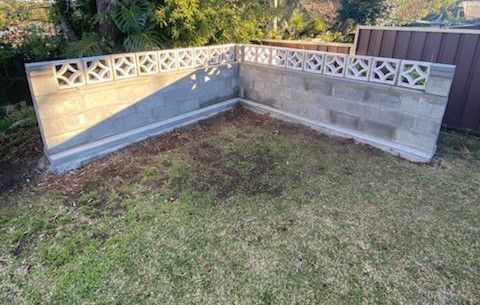

This is my biggest D.I.Y. project to date. An outdoor fire pit seating area. I made it from Besser Blocks and decorative breeze blocks.
I finished off with a Spotted Gum floating bench seat, decorative rocks and stepping pavers on the ground.

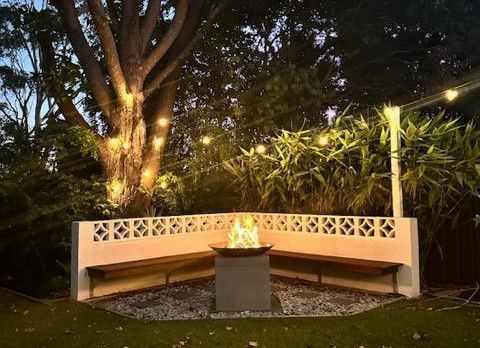

The post is to hang festoon lights up from our deck to the post and then to a tree.

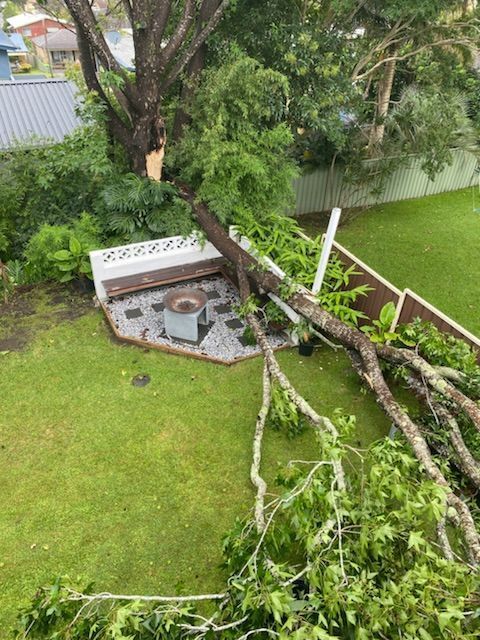

When a tree fell last year, the fire pit stayed relatively intact, apart from a couple of smashed breeze blocks.

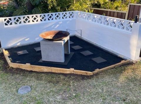

- It’s best to take your time to make sure the project turns out exactly how you plan, especially if you are trying a new skill like rendering or laying blocks.

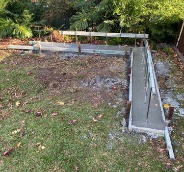

- Get a tradie to do the jobs you think would be worth having done right the first time, e.g. laying the foundation slab with vertical reinforcing bars, etc.
