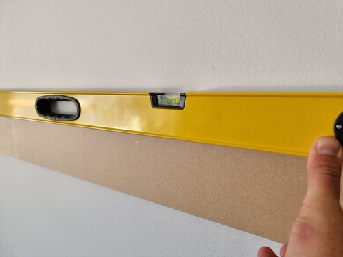

Time to measure
Decide the height and spacing of the battens. A common height for the battens is around 2/3 of the wall height, but you can adjust it to your preference.
Use a measuring tape, level, and pencil to mark the desired height of the battens on the wall. Ensure that the marks are level.

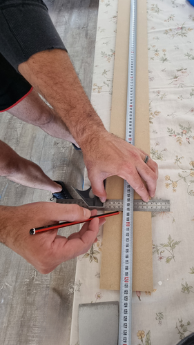

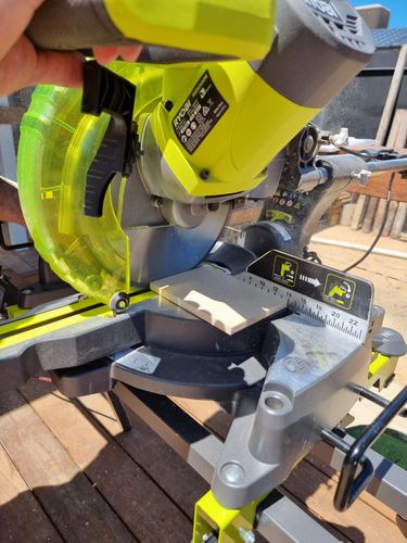

Make the cuts
Cut the MDF to the length and width for your desired look. We decided to have our battens be 100mm wide and a total height of 1330mm. We wanted to make sure that it didn't interfere with the light switches.
The length of each board was roughly 1060mm, however, there were some adjustments to be made due to our uneven walls. The top horizontal batten was measured to fit the length of the wall, this occasionally meant using more than one board.
On the right hand side of the entrance door we decided to add in coat hooks and a shelf so we extended the height to a total of 1910m.
We used a circular saw for the longer cuts and mitre saw for the short.
Don't forget your PPE for this step.

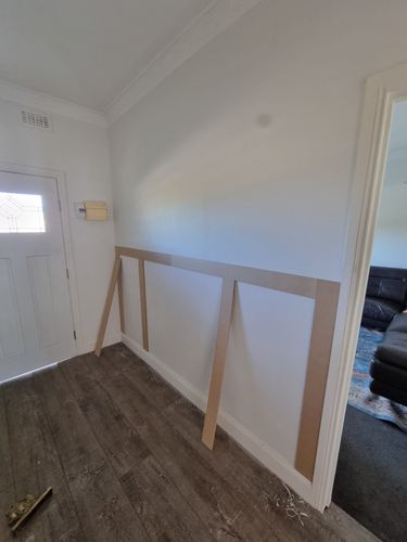

Step 4

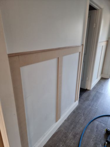

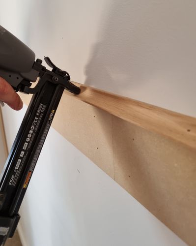

Install horizontal battens
Attach the horizontal battens to the wall, we used a nail gun but you can use a hammer and nails, although this increases the size of your gaps to fill later. Ensure they are level and aligned with the marked height of the battens. You can use a stud finder to nail them into the wall studs for added stability.
Step 5
Install vertical battens
Align your vertical battens against the pre-spaced marks on your wall. We made sure to double-check the spacing along the way.
Secure the battens to the wall using a nail gun or hammer and nails.

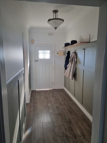

Step 8
Paint away
Use painters tape on any wall surface you don't want to get paint on.
Using the detail brush, do the inside corners first and then the roller brush to create a smooth finish.
LEARNING: I wish that we painted the trim before attaching and then touching up after nailing it. This would have prevented us from need to tape up the wall and need to cover and re-cover paint bleed from the tape.
Step 9

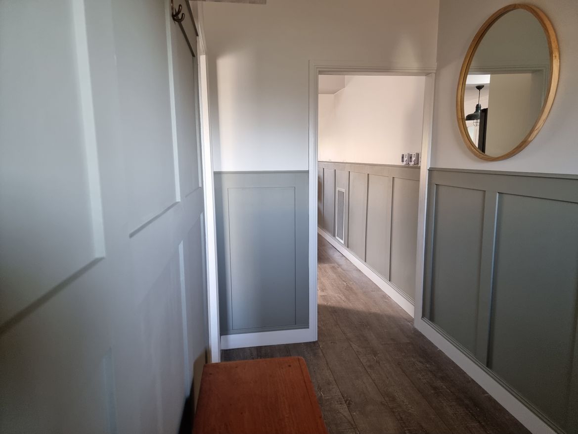

Enjoy your hard work

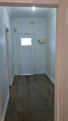

This was a really fun project that we absolutely love the outcome from. The next step is to replace the shelf with one that doesn't stick out so much, add a bench seat, and then onto relocating the electrical box and replacing with a nice side light window.
Before and after entryway:
