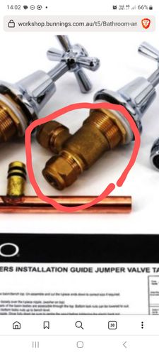

I'm thinking that I should change the fitting to allow for shallow seat 1/4 turn spindles that I already have.
Other than getting the whole basin set, does Bunnings sell individual fitting (I'm not sure what it's called)?
The bottom part you are looking at is called a basin stop body. It is sometimes costlier to purchase a single stop body by itself. I suggest purchasing the Estilo basin set and removing the spindles and keeping them for future repairs. You can still replace them with the 1/4 turn ceramic spindles that you like.
One other option is to purchase a complete ceramic basin set so that you won't have to take anything apart.
