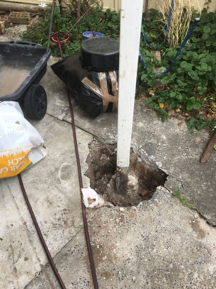

I am replacing steel posts, which hold up first floor verandahs, with Merbau posts. The last one was buried 60cm, which I have excavated, but now I need to build a pier to bring the timber post above ground level. Previously I have made a concrete pier but this one is deeper so I am thinking of build it out of bricks. I am uncertain how I can fix the stirrup to the top of the pier. I am thinking of putting a concrete pad on the top of the bricks and burying the bolts ( 130 mm gal ) into this concrete with the thread bolted down from the stirrup. What are your thoughts on this? If I build the pier entirely out of bricks, how would I fix the stirrup to the brick pier. Would dynabolts hold in the bricks or would the bricks break (I guess I would need to fill the holes in the bricks with concrete too).
![IMG_3263[1].JPG IMG_3263[1].JPG](https://us.v-cdn.net/6038643/uploads/migrated-attachments/a2f96e0cb5e01be85500bf508fe3f4bc.jpg)
![IMG_3261[1].JPG IMG_3261[1].JPG](https://us.v-cdn.net/6038643/uploads/migrated-attachments/fbb6364135adc820505bbfc881487f7b.jpg)
