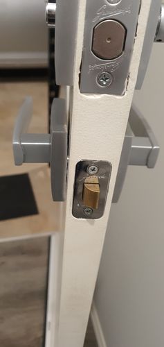

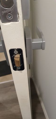

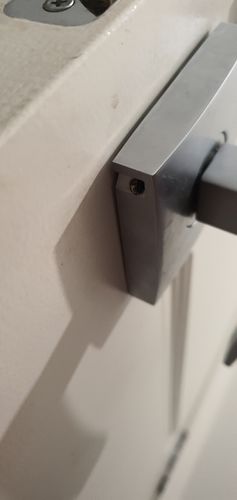

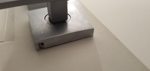

Hi, Can someone please suggest me how to fix loose door handles. The door has handles on both sides and it is loose from.both sides. I could notice grub screw holes on the bottom side of the handle and it is very inconvenient to tighten them.

I have checked the holes and found that grub screw are in there and are tight. In fact, I unscrewed them slightly and tried to position the handles closer to the door and tighten them again. But unfortunately it didn't work. Any suggestions please.

Are there any grub screws in those holes? I can't see any in your pictures, but they might be recessed deep down inside the threads.
It's likely inconvenient to tighten them, but ideally, they shouldn't come loose again once you've done so. You'll need to select the correct sized Allen key to suit them and then tighten them until the handles are no longer loose. If you find the grub screws are loosening off again, you can add some thread locker to their threads before inserting them. This product will stop them from backing out over time.
There's a reasonable chance that the grub screws have actually fallen out. In that case, you can replace them with those in these grub screw kits. Please let me know if you have any questions.
