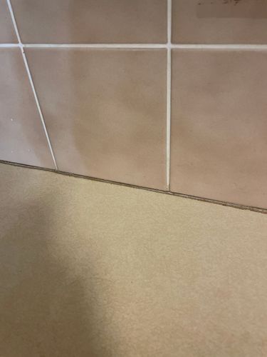

Should I use silicone or no more gaps between the kitchen bench and wall tiles? I’m redoing the bottom as it’s super old and cracked and ants are getting through.

I recommend using Silicone sealants that are designed for kitchen and laundry use. These types of silicone have been tested to work in kitchen and laundry environments that are exposed to heavy moisture, grease and food particles. They have mould resistance built into them and can withstand periodic cleaning.
My best suggestion is to make sure that all the old silicone has been taken off and the surface has been washed thoroughly to make sure there are no oil or grease deposits left behind.
Please make sure to wear personal protection such as gloves and goggles when applying the new silicone.
