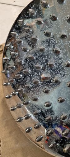

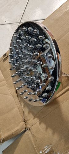

Over time, my bathroom's shower head is coated with some white dots. I am unable to remove them with Jif or washing detergent. How to remove them?

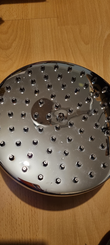

It works !
Look at this:
Hello @Makita
That shower head looks like its brand new! I'm sure @MitchellMc will be pleased to hear that the calcium deposits have disappeared and that his suggestion worked very well.
