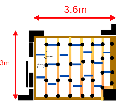

Hi folks. New member here and a very new to the world of DIY. I was hoping to get some advice on some of the questions I had in building a deck. I have read Adam W's article on how to build a low level deck here I posted the question below but will provide details first
Here are my details:

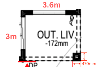

- 3m x 3.6m Alfresco deck on concrete with drainage in middle
- 172mm is the stepdown according to plans but I measured it was actually 190mm from the stacker door so I'm basing it on 190mm height
- For joists, I plan to use H3 treated pine 140x45mm (i need 8 of them with 450mm span each)
- For boards, I plan to use Merbau 90x19mm (I haven't counted how many I need from them)
- The boards are going from left to right.
- I plan to picture frame the deck
Question:
1.) Can I screw the joist to my brick wall using a galvanized hex head coach screw like this? Or maybe something longer screw because I'm using 140x45mm joists? I saw in Bunnings Youtube video here that they drilled the joist to the brick wall. I plan to do the same and use joist hangers for each and every joists connecting there. Is that advisable?
2.) On the black dots, I plan to use builders edge adjustable decking feet of 25mm. Do I need to drill the feet to the slab? As much as possible I don't want to drill anything to the slab unless it is required for my decking type.

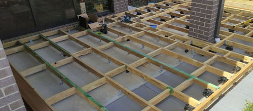

3.) I plan to do something like this but instead of angle brackets, I will use decking feet. Is that advisable?
