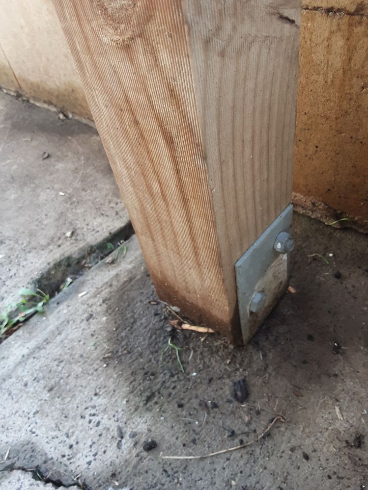

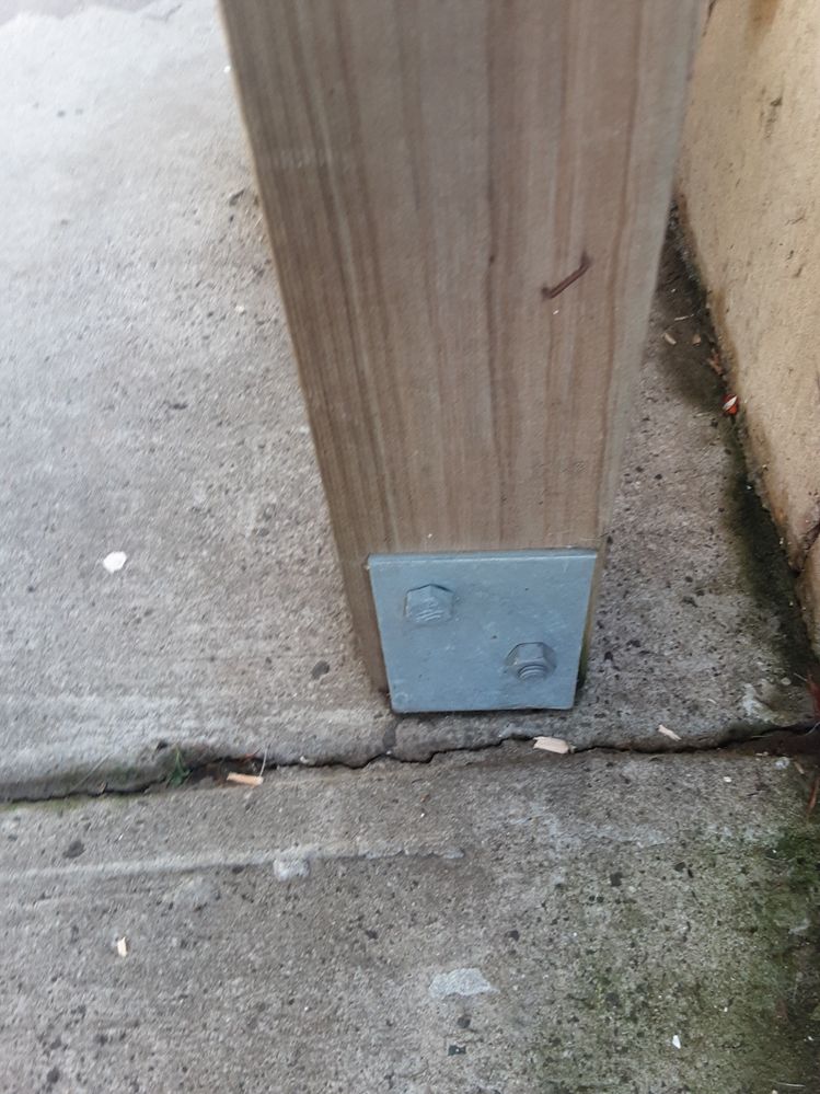

I'm planning to build a Catio under my Pergola BUT I need to fix a few problems 1st.
The main problem is my Posts holding up my Pergola, the builder has them too low to the ground being concrete.
What concerns me is the rain, the posts get soaking wet and I want to paint or stain them. I don't know what to do, even where to start.
Can someone please help me... I'm a pensioner, so cannot afford to get a Tradie in so please put that in mind. I will attach some photos separately because last time I tried I lost everything so I'm not sure what I'm doing wrong 🤔

My apologies for the late reply, if you are planning on painting them, I suggest using an exterior rated paint such as Dulux Weathersheild, Taubmans Sunproof or British Paints 4 seasons. The same rule applies when choosing oil and stains, it's important that the product you choose is rated for outdoor use.
Unfortunately, the post is bolted in place and the only way to paint the bottom is to have it disassembled which will be a challenging task. But you shouldn't worry about your timber posts. The minimum protection for this type of timber is H3 as it is being used in an outdoor structure. However, adding an extra coat of protection wouldn't hurt.
