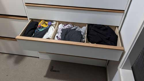

I also really wanted the drawers to have dividers which makes a massive difference to being able to keep the drawers tidy.

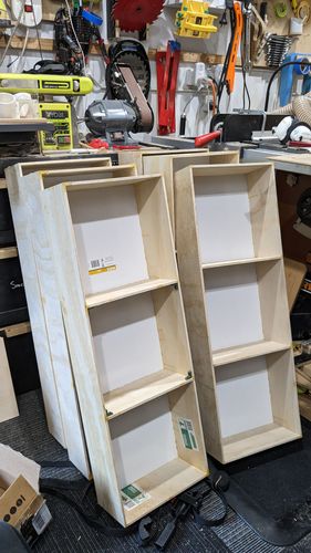

Ready for Glue Up
Glue mess
Then its just a matter of gluing everything together. I did one at a time with about 2 hours in between to give the glue time to take.
Note: 6 of the bases are in one piece (892 x 296mm), the other 1 need to use the 2 odd size base pieces which should meet under one of the dividers.
I made sure I assembled each draw all at once including the base as the base helped keep the drawer square. I also used a framing square to check before letting the glue go too far.
Everything was then left for a few days to let the glue completely cure (and for it to be the weekend again).

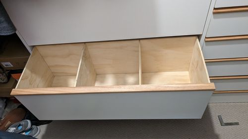

Double depth drawer
Finished
Standard height drawer

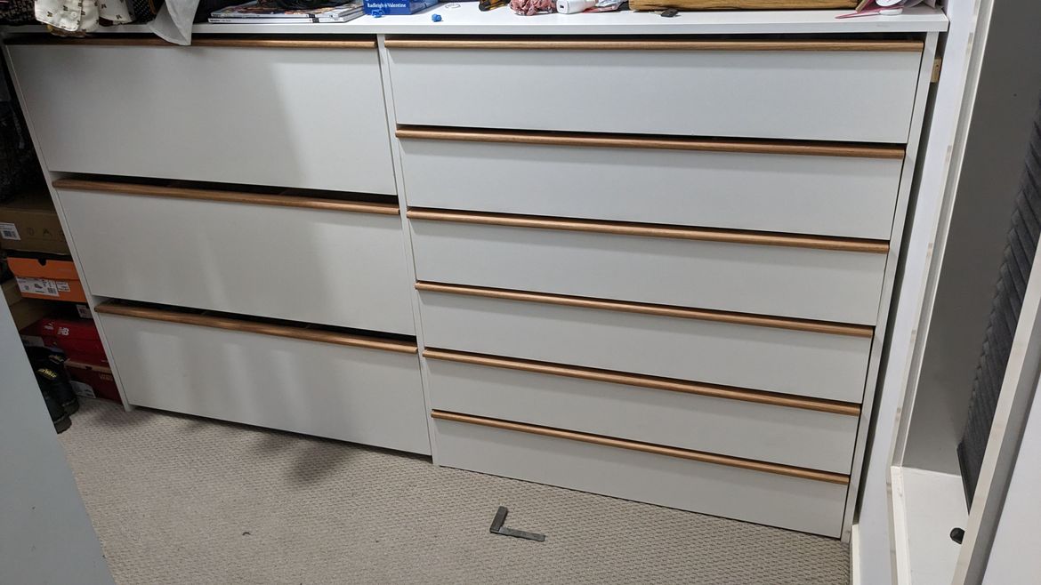

I decided to build these into the wardrobe using melamine sheets attached to the wall with metal angle brackets for the surround rather than having it freestanding. I used 300mm full extension 'push to open' drawer slides so I didn't need handles you can walk into in the narrow space.
The drawer fronts are optional too, I could have just painted the ply, but I opted to make some melamine fronts with a little oiled timber accent.
This has added an enormous amount of storage to the space and was completed for quite a bit less than the equivalent flatpack sets would have cost.
