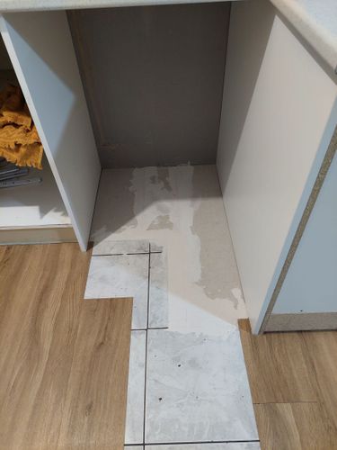

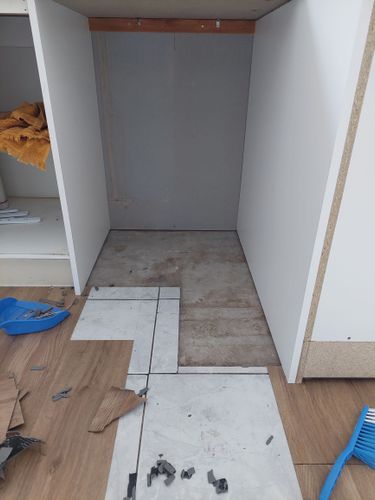

Step 1
I scrapped off any tile glue and grout to make sure the surface was clean and level.
I also removed some of the shorter vinyl flooring boards to ensure the new ones blended in well.

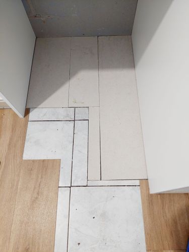

Step 2
I then cut pieces off the 7mm FCS to fit the section of flooring. I glued these down using construction adhesive.
Thankfully this was about the same depth as the tiles, before laying the vinyl flooring.
Step 3
I then applied the jointing compound and let it dry accordingly.

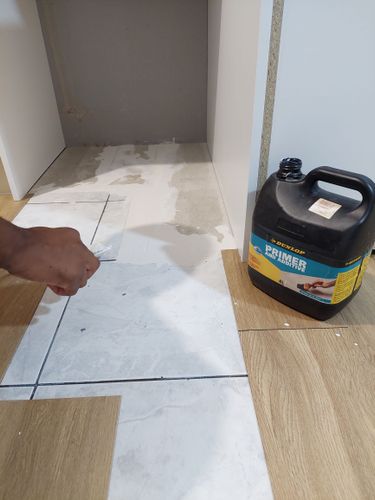

Step 4
I then applied for primer to the boards and tiles in preparation for laying the vinyl planks.

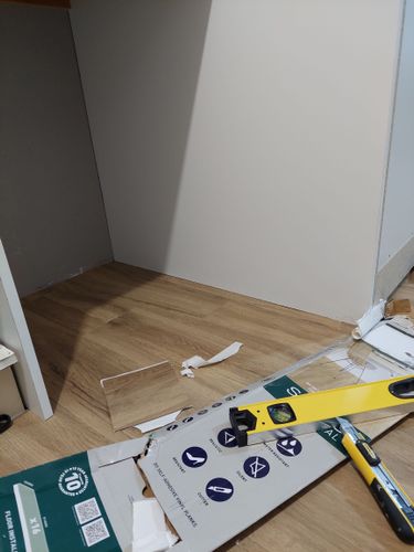

Step 5
Then I cut and glued down the self adhesive planks as per instructions.

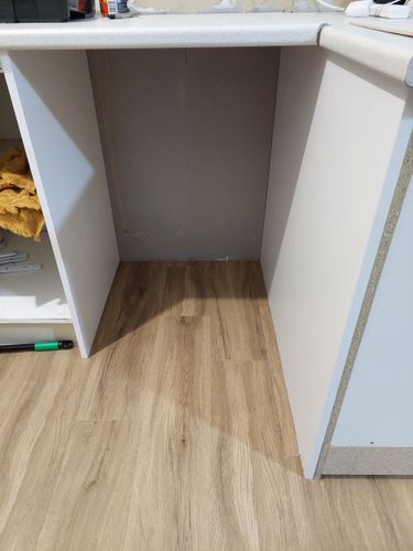

Step 6
I then pressed down the vinyl flooring to ensure they had bonded and gave the area a good clean.
