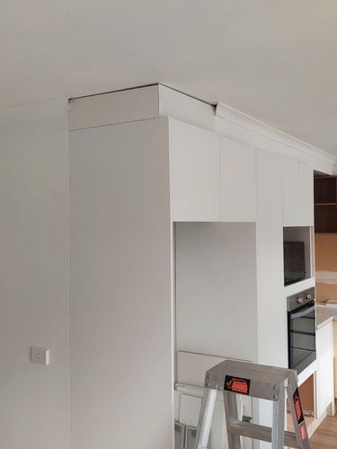

Step 2
I built a three sided frame including a base that attached to the upper side of the cabinet below. This aligned with the existing wall and bulkhead.
Step 3

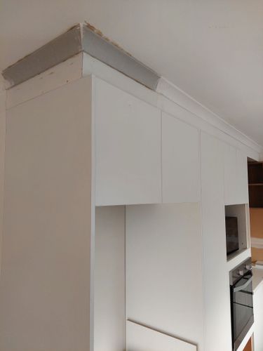

I then cut some pieces of cornice to size using a mitre box and hand saw and glued them on using construction adhesive.
I also applied some plaster to tidy all the joints up.

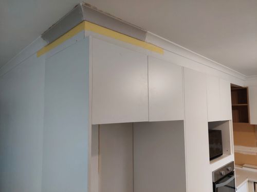

Step 4
Then I taped the wall and ceiling sections and painted them separately.

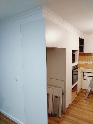

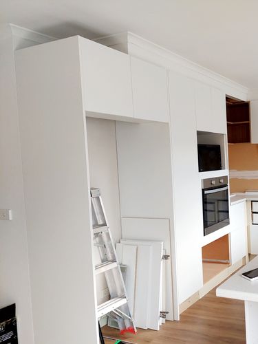

Step 5
Completed the paint work and the bulkhead and cornice look like they've always been there.
