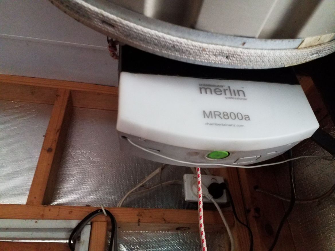

Would it be possible for you to post a photo of the model number of your garage opener. I can then ask Merlin what the compatible remotes are and if the frequency it emits will be different from your old remote.
If you need a hand posting the photos, please let me know.
Thanks for posting that photo of your Merlin garage motor. I'll contact Merlin to get more information on compatible remotes. I'll get back to you as soon as I have more information.
Thank you for your patience.
I've been in contact with Merlin's technical department, and they suggested a compatible remote like the E960. They also assured me that the pairing the new remote to your garage opener will not allow your old remotes to work. They've requested that you contact their customer service line at 1800 638 234 and speak to Tara. They want to make sure that your garage opener is properly set up and your old remotes removed from your system.
