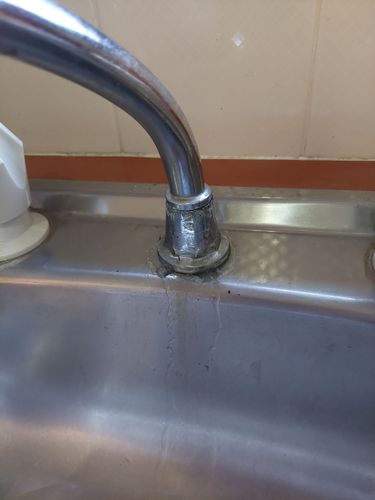

hi all, I need to remove the kitchen spout flange. I have removed the grub screw and spout. I'm just struggling with the next step. Is it supposed to unscrew? Hoping you can help. Regards, Amy

You'll notice that the bottom of the flange has flat angled sections. This is where you'll need to place your adjustable shifter and turn the flange anti-clockwise. Once it is loose you should be able to turn it by hand.
Please note that it might be necessary to engage a licensed plumber to complete this work. If in doubt, please consult your local building authority before going any further.
