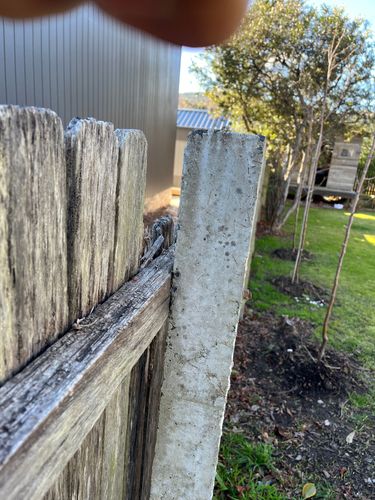

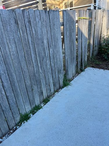

I’m adding photos of the fence. The idea is to replace the palings and railing and the wood in planning to use for the railing. The bolts are to at each the railing to the concrete posts
Hello @totocol
Thanks for that extra information about the concrete posts. I was also wondering what the nut and bolt were for. My only suggestion to your new fence upgrade is to add a timber capping over your fence. The capping will serve as a defence for the top of the paling and prevent water from sitting on its cut end.
It looks like you've got all the parts you need. I only suggest double checking the size of the current raling. It's best to use the same size so that you won't get any bowing in the fence. Please don't forget to post photos while you are dis-assembling and re-assembling the fence. I'm sure our members would be keen to see the process.
